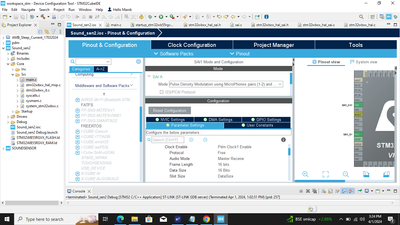

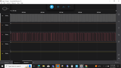

Maniksb09
We Have SAI Interface through it I am trying to read RAW data from sensor But unable do it. We are able get some data but the obtained data cannot be analyzed.
Also I am unable to find pdm2pcm under middleware and software packages to activate.(STM32WB55RGV) Doesn't it support conversion??
So we presume that PDM to PCM IC converter is required. Please share your thoughts on this???
If there is any eval board on sound sensor(IM69D130) please do suggest the part number for it or any other suggestions.
The picture shows the PDM data we received and configuration.
CH-01 is clock
CH-03 is PDM data.
Thanks and regards
Manik.
