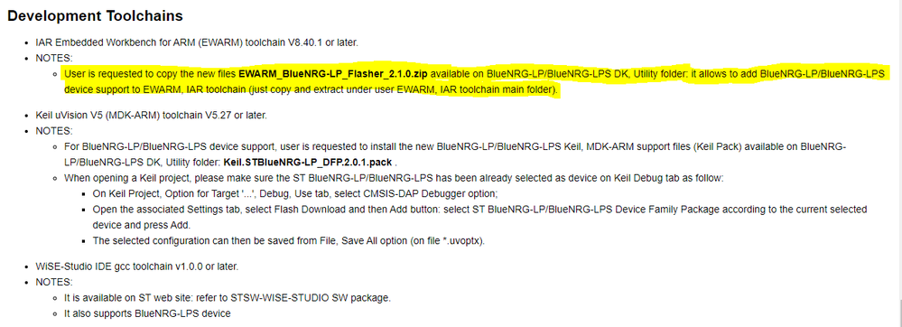

If BlueNRG-LP is not supported by your IAR version, a Add-on pack is available on SDK (Utility folder)
You may refer to below extract from SDK release note :
Hope it helps.
Regards,
Sebastien.
BCHEN.1
C:\Program Files (x86)\IAR Systems\Embedded Workbench 8.4
Is this the folder right for EWARM_BlueNRG-LP_Flasher_2.0.0 ?
Yes : it should be the correct folder. This is your IAR installation folder.
EWARM_BlueNRG-LP_Flasher_2.0.0 is a Add-on for IAR.
It uses same folder hierarchies ad architecture as IAR installation folder.
