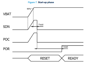

Hi nasramine,
Please check SPI connection and SDN.
During start-up, SDN must be kept high for at least 1 ms.
Please refer to datasheet, Figure 7:
https://www.st.com/resource/en/datasheet/s2-lp.pdf
Best Regards,
Winfred

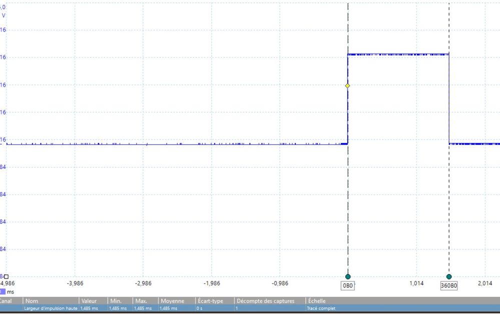

BMoha.19
Hi Winfred,
Thanks for your quick answer.
During start-up, SDN was kept high for 1,485 ms as mentioned on below measurement:

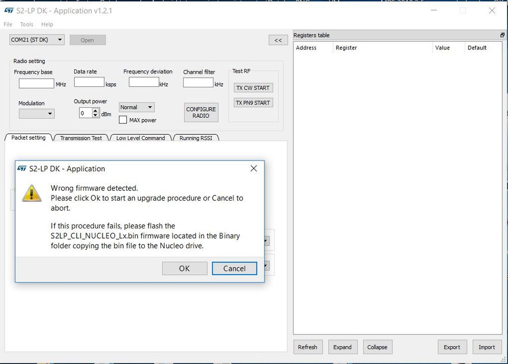

When i try to connect with S2-LP DK tools to my board (based on STM32L0xx) i have below problem:
Any proposal for the problem please?

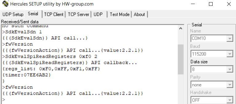

Hi Mohamed,
Could you try connect the Virtual COM port and check the output for the followed commands:
  1. SdkEvalSdn 1
  2. SkdEvalSdn 0
  3. SdkEvalSpiReadRegisters 0xf0 2
  4. fwVersion
  5. SdkEvalGetVersion
  6. S2LPGetVersion
  7. EepromReadPage 0 0 1
  8. EepromReadPage 0 0 32
Best Regards,
Winfred
Hi Winfred,
With eval board NUCLEO-L152RE i can run commands as below (after fashing CLI binary with S2-LP DK tools):
but when i used my customer board (based on stm32l0), commands cannot be runned. I think, it's related to CLI binary.
Can you please share with me source code of CLI?

Hi Mohamed,
Please use STM32L053 for the board and flash S2LP_CLI_NUCLEO_L0.bin instead.
Regarding to the source code, sorry that currently there is no plan to share it publicly.
