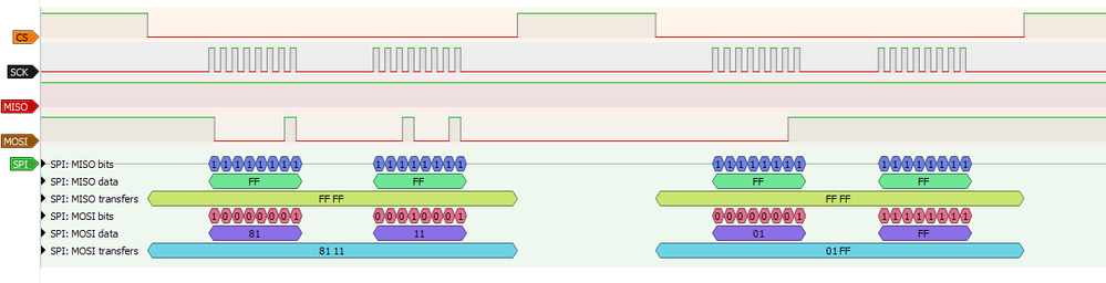

So, I've gone back through the documentation for the MCU and the slave device (AMIS-30543) and got a logic analyzer. I've updated the code some and I think I've narrowed down where the error may lay. Here is a screen grab of the logic analyzer results and updated code.
The slave device's documentation is here. It states it must receive a command+address byte followed by an empty byte in order for one of its registers to be read.
https://www.pololu.com/file/0J869/AMIS-30543-D.pdf
It looks like I'm correctly sending 8 bits of data to the slave device, but am still receiving blank data in return.
Code:

waclawek.jan
At this point, I don't know. As it's the AMIS chip which does not answer to what appears to be a correct sequence, it's then either incorrect wiring, bad solder joints, or faulty chip...
I'm very happy to report it is working now; soldering the joints did the trick. I soldered the pins now instead of simply laying the chip on top of the breakout pins (I thought the contact was sufficient, but was clearly wrong in that assessment). The stepper motor now spins as instructed.
