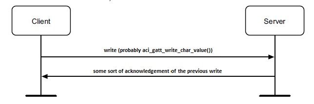

"If not, then please please share with US how I can get some sort of acknowledgement on the CLIENT from the server that the server received the data."
i.e. CLIENT sends data to server, CLIENT needs to know if data was received on the SERVER. The opposite of the diagram in the previous post
‎2019-12-11 10:48 PM

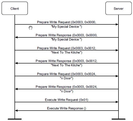

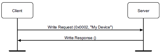

Yes. The notification shall work according to your needs.
To use ATT write is another option, which is more specif than to use ACI_GATT_UPDATE_CHAR_VALUE.
Please according your configuration use ACI_GATT_WRITE_CHAR_VALUE, ACI_GATT_WRITE_LONG_CHAR_VALUE, or ACI_GATT_WRITE_CHAR_RELIABL.
