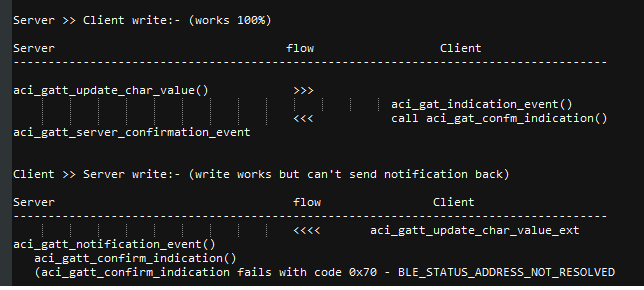

I'm trying to :-
A> use one characteristic that Server can use to write data to Client with indication
B> use same characteristic so that Client can send data to Server with indication
the characteristic is set up as follows aci_gatt_add_char(....CHAR_PROP_READ|CHAR_PROP_INDICATE|CHAR_PROP_WRITE on both Client and Server
I have achieved A> and works pretty well, however I'm having problems with B>
the problem is even though I can send easily send the data from Client to Server and Server is receiving the data in the aci_gatt_notification_event()
How can I achieve notification back? I'm happy to have the Client >> Server write on a separate Characteristic

I did ret = aci_gatt_set_event_mask(0x7FFFF); on server end and added aci_gatt_attribute_modified_event() handler but handler never gets call even though the write is still working.
What was wrong with catching the write responce in aci_gat_notification_event() in my original post- this works (its just I cant send a notification back to say that I have received.

Are you saying it's not possible to achieve what I'm asking for?
If not, then please please share with US how I can get some sort of acknowledgement on the CLIENT from the server that the server received the data.

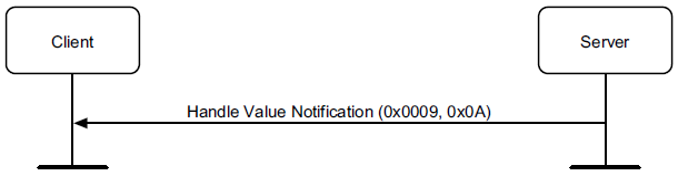

Notification is used when a server is configured to notify a Characteristic Value to a client without expecting any Attribute Protocol layer acknowledgment that the notification was successfully received.

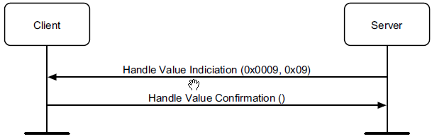

Indication is used when a server is configured to indicate a Characteristic Value to a client and expects an Attribute Protocol layer acknowledgement that the indication was successfully received.
Back to the question of using ACI_GATT_UPDATE_CHAR_VALUE,
If notifications (or indications) are enabled on that characteristic, a notification (or indication) will be sent to the client after sending this command to the BlueNRG-1.
On the GATT client the callbacks will be called accordingly, either aci_gatt_notification_event() or aci_gatt_indication_event().
But in the case indication is used, on the client you have to confirm the indication reception using the command aci_gatt_confirm_indication().
