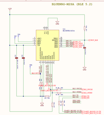

A BLE Project for developed on steval-mksbox1v1 which had SPBTLE-1s.
Since it became NRND we switched to BlueNRG-M2SA Module which has same footprint.
Using the BlueNRG-1_2 DK 3.2.3 I have tried to get build the project with following pin changes as per mksbox connections - in hw_config.h
#define SPI_CS_PIN GPIO_Pin_1
#define SPI_OUT_PIN GPIO_Pin_2
#define SPI_IN_PIN GPIO_Pin_3
#define SPI_CLCK_PIN GPIO_Pin_0
But to my despair the in the built project binaries flashed into the module, the IRQ pin never becomes high in this firmware and the HCI code does not progress as IRQ low. In short the module does not initialize.

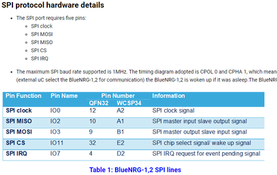

Please note DTM SPI FW for BlueNRg-M2 is already provided in BlueNRG-1_2 DK 3.2.3.
You will also find in this SDK documentation, the recommended mammping for SPI and IRQ (corresponding to this FW).
I then recommend this SPI mapping and the provided DTM SPI FW.
Regards
Laurent

If you check steval-mksbox1v1 sensortile board schematic, in that board the pins are not same as the firmware binary or source code provided in BlueNRG-1_2 DK 3.2.3.
Our board was made on that basis thus my pins are as following -
#define GPIO_MODE_SPI Serial0_Mode
#define SPI_IRQ_PIN GPIO_Pin_14
Regards

Ok but the point is that  if you refer BlueNRG-2 datsheet (BlueNRg-2 is the SoC included inside BlueNRG-M2 module), you will see SPI CS can be set using aither DIO1 or DIO11 (see bluenrg-2 datsheet table 130)
But DIO1 is not a wake up capble IO (see BlueNRG datasheet chapter 3.4.1.3)
So if you use a DTM SPI FW inside BlueNRG-2 that is having sleep mode enabled, DIO1 will not be able to wake up BlueNRG-2/BlueNRg-M2
So either you use DIO11 pin as CS pin and you can use a DTM SPI FW with sleep mode, either you need to disable sleep mode in DTM SPI FW if you want to use DIO1.
Regards
Laurent

I very well get your this point. Due to this concern what I did is I keep DIO1 as the chip select but I also operate DIO11 from another GPIO(USAR2_BLE_RX_UC_TX) along with the CS function to wakeup and sleep the BlueNRG Chip.
The question though is not about sleep majorly but basic SPI Communication with the BLE IC.
I have noticed the BLE SPI INT Pin does not go high and due to which other codes SPI Write gets stuck waiting for it.
Regards
Kashyap

May be could you confirm using DIO7 as IRQ as our default example, you can see IRQ rising up (you can add wire to modify your PCB)?
Laurent

As you can see we are using DIO14

My request is maybe to rebuild FW with DIO7 as IRQ and modify your PCB as a test.
DIO7 is the default IRQ used in our example.
This is to see if this is related to DIO14 and any specifc thing around it.
Laurent

In mksbox sensor tile DIO14 is used.
Could you, if possible, share the original firmware source code of DTM_Spi used in sensortile board?
That is not available online. I want to check the project because that firmware works fine on my board. its the new firmware i create which are not working.
