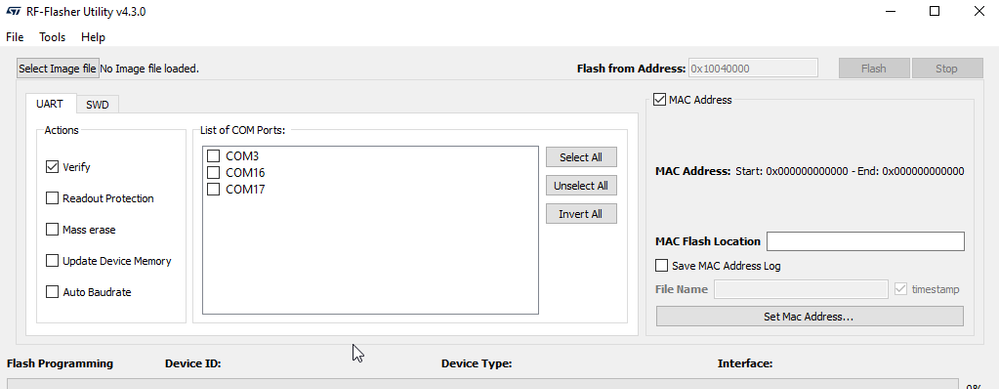

Hi @Winfred LU
Thank you for your prompt reply.
I would like to exploit BLUENRG-X-FLASHER UTILITY ability to program MAC Address to BLUENRG-2  from the ST-link command line interface in mass manufacturing. Is it possible to do my intention?
Thank you in advance.
Ilker B.
Winfred LU
Hi Ilker B,
The function has been already available in RF-Flasher Utility.
at the top right corner in the GUI:
https://www.st.com/en/embedded-software/stsw-bnrgflasher.html

Hi @Winfred LU ,
I use this option exactly. But my problem is that; how to read this flash address from my host microcontroller  ?
Regards,
Ilker B.
Winfred LU
Do you mean in host uC to read M2SP's flash thru ACI? There would be no such stack library ACI to pass some flash data.
The simplest workaround is to program the data (MAC address in this case) in the flash on host uC, then in the application read the data accordingly.
