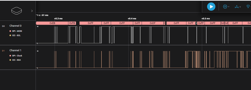

But I2C2 not, after reset on PB6 and PB7 I just get some messy signals as below, It seems the I2C2 is not initialized with succcess.

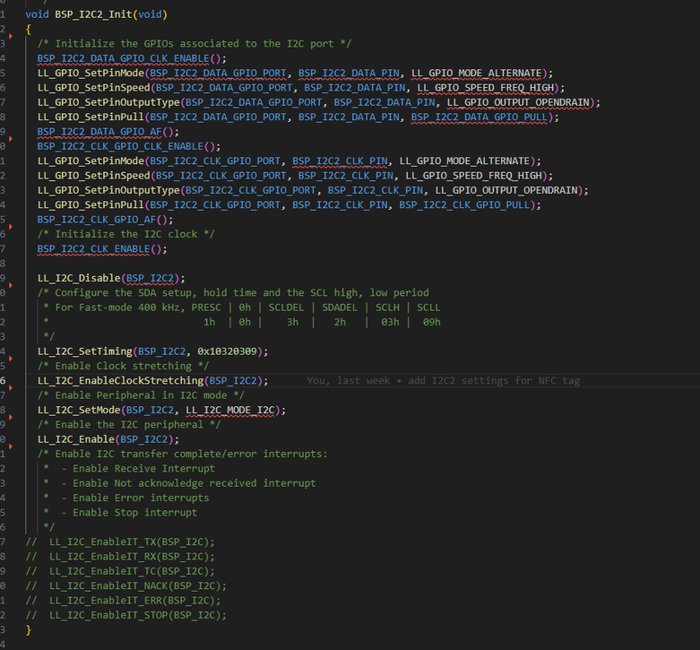

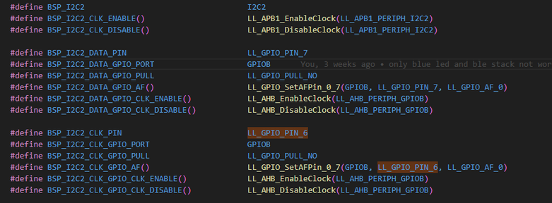

Let´s make this question more simple, only I2C2(PB6/7) is not working
this is the pin definition:
this is my init function:

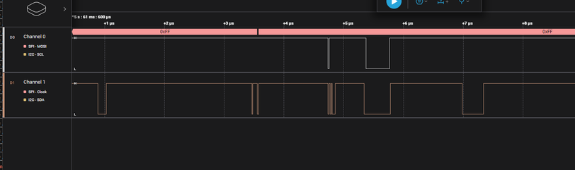

Danny0007
Senior
even the clock signal is not correct:
Rene Lenerve
Hi Danny0007,
Here are some points to check as both I²C are initialized identically:
- Check I²C registers are correctly set in the MCU just before first communication (need debug)
- Check I2C2EN = 1 and I2C2RST = 0 (need debug)
- Check pull-up resistors are correctly soldered on I²C bus lines SCL and SDA (externally to MCU, keep GPIO no pull up option set in MCU)
Could you get a capture of the first byte sent (device select) for I²C1 and I²C2.
Kind Regards.

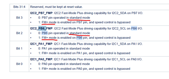

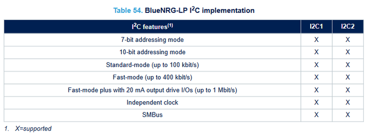

I found this in the document RM0479 page 106:
Does it mean that the PB6/7 as I2C2 only support either standard mode or FM+? Fast mode at these pins are not supported. Because in my init function for I2C2 I just copied the timing setting from I2C1(PB10/11), which supports fast mode.

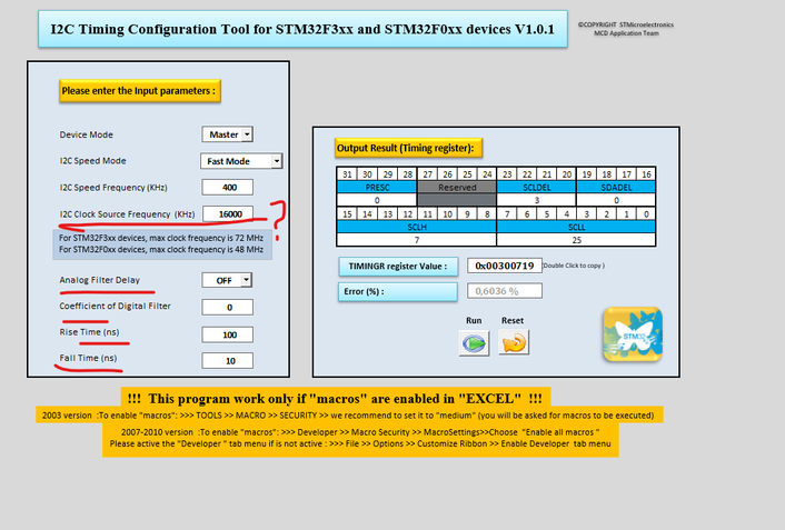

I do find this tools from ST and try to reproduce this settings, then change it to standard mode or FM+
If this is the reason, could you teach me how to set the parameters in the table correctly and firstly reproduce the timing setting for fastmode?
Rene Lenerve
Hi Danny0007,
The Fast mode+ allows the I²C to operate at 1Mbit/s, compared to the standard mode and the fast mode speed which are 100kbit/s and 400kbit/s respectively. Both I²C1 and I²C2 support all these modes, but for FM+ on dedicated pins.
I2C I/Os supports 20 mA output current drive for fast-mode plus operation.
This is enabled by setting the driving capability control bits for SCL and SDA
in Section 8.2.3 I2C Fast-Mode Plus pin capability control register (I2C_FMP_CTRL).

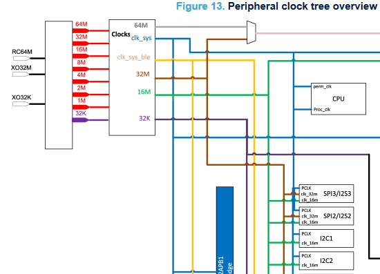

The timings from I²C1 are based on a 16MHz I²C source clock and are given in the Reference Manual in the table 58
The clock for I²C1 and I²C2 is fixed and set to 16MHz (picture from RCC section, green line)
The PCLK is used for registers only (blue line, Figure 83 in Reference Manual).

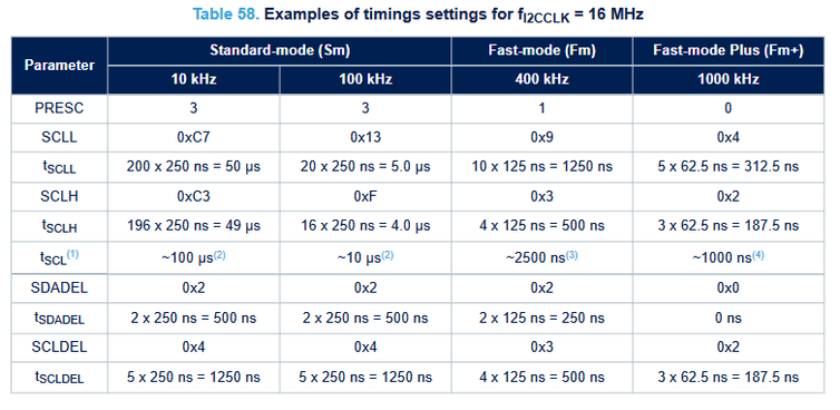

So if you want to change the i²C mode, refer to table 58.

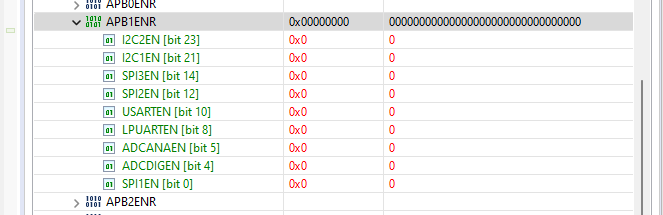

and the values in APB1ENR are unnormal:

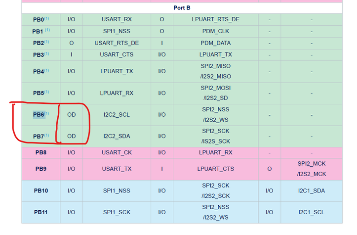

Hi @Rene Lenerve
I see on page 16 table 6:
PB6/7 are opendrain in AF0, different from others... maybe need some special settings?

ladies and gentlemen,
I measured the power pin and put my board under microscope and find out it was a power issue.
Now clock signal is normal.
