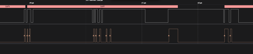

hello community,
I´m using PB10/PB11 as I2C1 and PB6/PB7 as I2C2.
I2C1 works correctly.
But I2C2 not, after reset on PB6 and PB7 I just get some messy signals as below, It seems the I2C2 is not initialized with succcess.
Actually the both I2C are initialized in the same way:

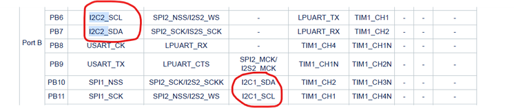

Here is the pin definition for both I2C
//sensor1
#define BSP_I2C                                   I2C1
#define BSP_I2C_CLK_ENABLE()                      LL_APB1_EnableClock(LL_APB1_PERIPH_I2C1)
#define BSP_I2C_CLK_DISABLE()                     LL_APB1_DisableClock(LL_APB1_PERIPH_I2C1)
#define BSP_I2C_DATA_PIN                          LL_GPIO_PIN_10
#define BSP_I2C_DATA_GPIO_PORT                    GPIOB
#define BSP_I2C_DATA_GPIO_PULL                    LL_GPIO_PULL_NO
#define BSP_I2C_DATA_GPIO_AF()                    LL_GPIO_SetAFPin_8_15(GPIOB, LL_GPIO_PIN_10, LL_GPIO_AF_2)
#define BSP_I2C_DATA_GPIO_CLK_ENABLE()            LL_AHB_EnableClock(LL_AHB_PERIPH_GPIOB)
#define BSP_I2C_DATA_GPIO_CLK_DISABLE()           LL_AHB_DisableClock(LL_AHB_PERIPH_GPIOB)
#define BSP_I2C_CLK_PIN                           LL_GPIO_PIN_11
#define BSP_I2C_CLK_GPIO_PORT                     GPIOB
#define BSP_I2C_CLK_GPIO_PULL                     LL_GPIO_PULL_NO
#define BSP_I2C_CLK_GPIO_AF()                     LL_GPIO_SetAFPin_8_15(GPIOB, LL_GPIO_PIN_11, LL_GPIO_AF_2)
#define BSP_I2C_CLK_GPIO_CLK_ENABLE()             LL_AHB_EnableClock(LL_AHB_PERIPH_GPIOB)
#define BSP_I2C_CLK_GPIO_CLK_DISABLE()            LL_AHB_DisableClock(LL_AHB_PERIPH_GPIOB)
//sensor2
#define BSP_I2C2                                   I2C2
#define BSP_I2C2_CLK_ENABLE()                      LL_APB1_EnableClock(LL_APB1_PERIPH_I2C2)
#define BSP_I2C2_CLK_DISABLE()                     LL_APB1_DisableClock(LL_APB1_PERIPH_I2C2)
#define BSP_I2C2_DATA_PIN                          LL_GPIO_PIN_7
#define BSP_I2C2_DATA_GPIO_PORT                    GPIOB
#define BSP_I2C2_DATA_GPIO_PULL                    LL_GPIO_PULL_NO
#define BSP_I2C2_DATA_GPIO_AF()                    LL_GPIO_SetAFPin_0_7(GPIOB, LL_GPIO_PIN_7, LL_GPIO_AF_0)
#define BSP_I2C2_DATA_GPIO_CLK_ENABLE()            LL_AHB_EnableClock(LL_AHB_PERIPH_GPIOB)
#define BSP_I2C2_DATA_GPIO_CLK_DISABLE()           LL_AHB_DisableClock(LL_AHB_PERIPH_GPIOB)
#define BSP_I2C2_CLK_PIN                           LL_GPIO_PIN_6
#define BSP_I2C2_CLK_GPIO_PORT                     GPIOB
#define BSP_I2C2_CLK_GPIO_PULL                     LL_GPIO_PULL_NO
#define BSP_I2C2_CLK_GPIO_AF()                     LL_GPIO_SetAFPin_0_7(GPIOB, LL_GPIO_PIN_6, LL_GPIO_AF_0)
#define BSP_I2C2_CLK_GPIO_CLK_ENABLE()             LL_AHB_EnableClock(LL_AHB_PERIPH_GPIOB)
#define BSP_I2C2_CLK_GPIO_CLK_DISABLE()            LL_AHB_DisableClock(LL_AHB_PERIPH_GPIOB)

Rene Lenerve
Hi Danny0007,
Great that it's working now.
For BlueNRG-LP and CubeMX, sorry for the confusion, this MCU is not available in cubeMX I was merely thinking about the timing computation for the I²C, but as the peripheral clock is fixed for I²C, there is no need to recompute timings, those provided in the Reference Manual are sufficient.
Hope this can help you
Kind Regards.
