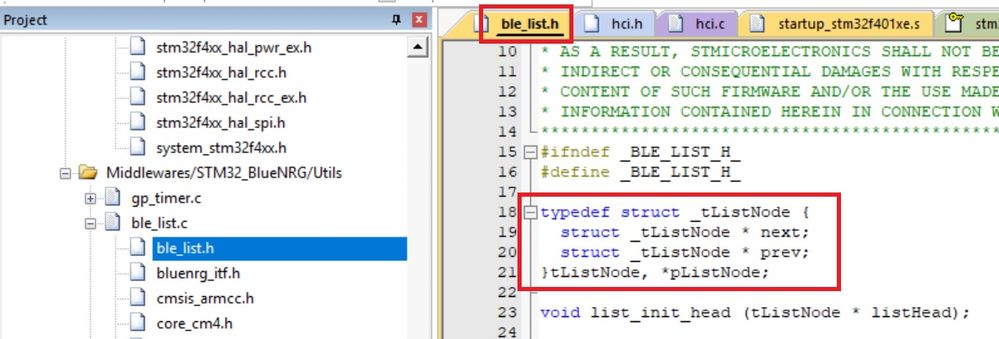

Posted on March 22, 2018 at 23:00
tListNode is defined in ble_list.h and is included in the project:
Posted on March 22, 2018 at 23:04
No, same issue. Extracted the zip folder to the desktop and opened the project from there. You would expect it to work as it is provided from STM.
