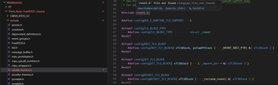

and because of these errors some headers are not found, like:

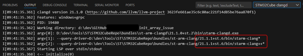

Hi @ANeam.1 ,
could you check what STM32Cube clangd outputs under “OUTPUT” when you run it?
After opening the project in VSCode and opening the first source file, I get this:

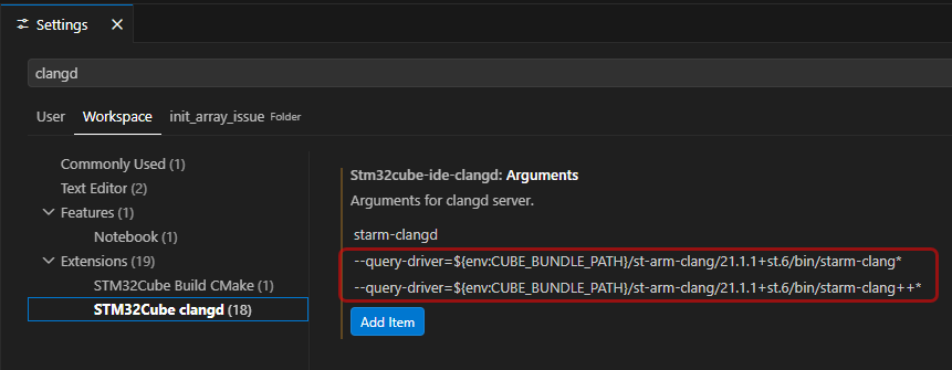

If you see here old versions, please check the VSCode settings:
(Depending on whether you're using a workspace file, the storage location varies: Workspace, or project folder.)
To get the correct path here, simply delete the two entries (preferably in the JSON view), save the file, close VSCode, and reopen it. The latest entry should now be used.

1. clangd - multilib.yaml - IncludeDirs
2. the not updated query-driver path?
As for the second point: It would be nice if the STMCubeIDE extension asked the user after updating the toolchain whether the paths should also be updated (or did I just not see that?

Hi @FluxPower42 ,
Yes, for this specific bug, I made sure I have the latest drivers for --query-driver. Although I did update them manually after I updated them in the bundles manager through the extension.
I agree with you that it is tedious to update them each time you update the bundles manually. I even have other places where I need to do the same trick. Maybe there is a solution to abstract these in some sort of common place and everywhere else use the alias? Just thoughts.
