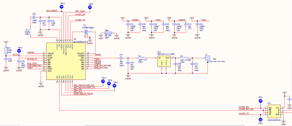

This is the BlueNRG-345 part of the schematic. Hopefully this is clear enough for you to read.
0693W00000bhZQ8QAM.pngThe HSE, Y2, is an ECS-320-8-37CKM-TR.

Laurent LOUAZON
Hi Rob,
I see some problem here.
C24 should not be a cap but a 10uH coil.
Also recommended value for C32 is 220nF.
Regards

Hi Laurent
It turns out that our hardware guys had spotted the C24 cap/coil error already as without this change the board would not work at all. They have now changed cap C32 to 220nF and this cures the problem I was having with the firmware going into a reset loop.
