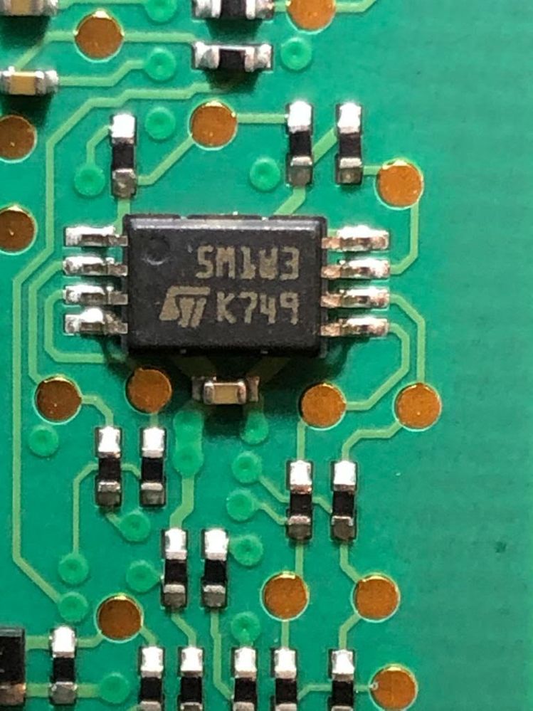

ST part?? marking code 5M1W3 K749 I want to find ST part from marking code. It`s 8 pin ic. Marking code below - 5M1W3 K749

This is an 1Mbit SPI automotive in TSSOP8 package.(commercail product = M95M01-DWDW3TP/K)
See root part number : https://www.st.com/content/st_com/en/products/memories/serial-eeprom/automotive-serial-eeprom/m95m01-a125.html

Is the part number M95M01-DWDW4TP/K have marking code 5M1D4 / K115?
