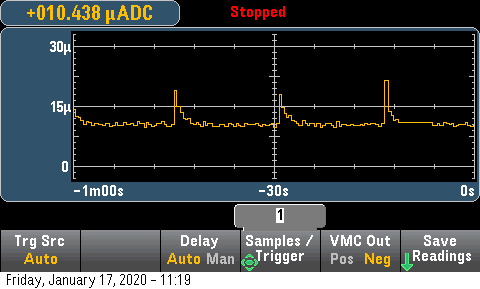

ANath.1
@Winfred LU​
The callbacks are triggered according to the large timeouts, however, the MCU wakes from sleep in 15s and increases the power consumption of the system. I have a system where the sleep time is configured for 15 mins but the system returns from SLEEPMODE_WAKETIMER in 15s and does not go into sleep again which means we have 14 mins 45 s of CPU running which consumes ~2mA, reducing the battery life to just 3-4 days. Also, there is no mention of this behaviour in the datasheets(At least I couldn't find some). How can we implement a solution in which the system sleeps for a longer time? In leveraging the large callbacks, we lose on battery life

@Winfred LU​
>The system needs to wake up at the first 15 seconds, quickly do some HW chores, go to sleep again, then wait for the next 15 seconds.
This isn't the behavior observed. The system keeps running after waking up from 15s sleep. I can confirm this by running the beacon for 15 mins interval on the battery and observing is its discharge. The battery calculator here supports this observation. I am able to achieve only ~4 days of battery. The current while sleeping for 15 mins should ~1uA, but is only for 15s and the rest 14 m 45 s (885 secs) is around 2mA.
Are there any functions/APIs to confirm that the MCU is going back to sleep after 15s ?

In the 15-minute sleeping periods, the system has to wake up at each 15 seconds due to the internal mechanism, then it can go to sleep after that short amount of time.
Recommend to review the application code especially for the 15-minute periods that it shall enter low power (sleep) mode properly.
Exactly the problem I suspect. How do we ensure that the system is going back to sleep after waking up? I tried adding printfs and led blink, they seem to be executed only once it when wakes up from sleep.
