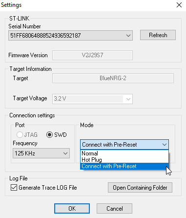

Winfred LU
Possibly it is because that the Reset pin is controlled properly.
Please refer to Target | Settings | Mode in ST-Link utility,
For the mode "Connect with Pre-Reset", it is useful in many cases like when the target contains a code that disables the JTAG/SWD pins.

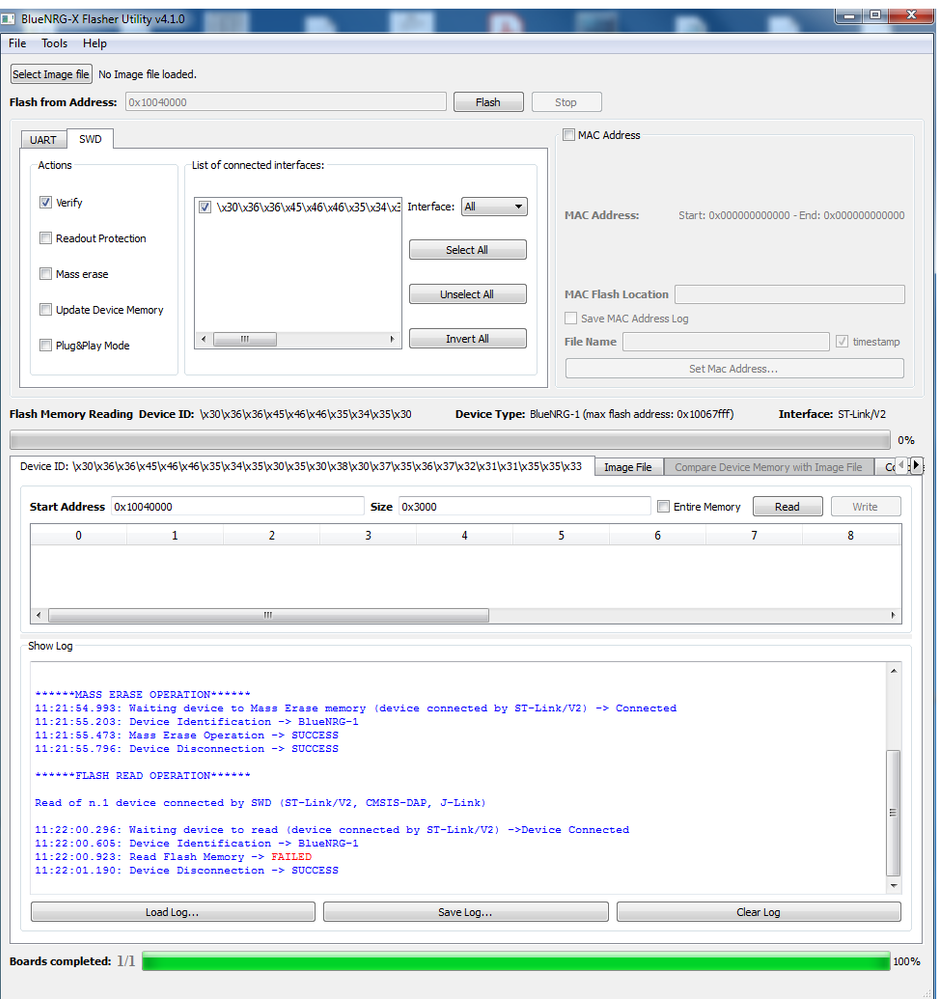

I know it's old, but were you able to solve this problem? I'm facing the same now
Please try to erase the flash firstly.

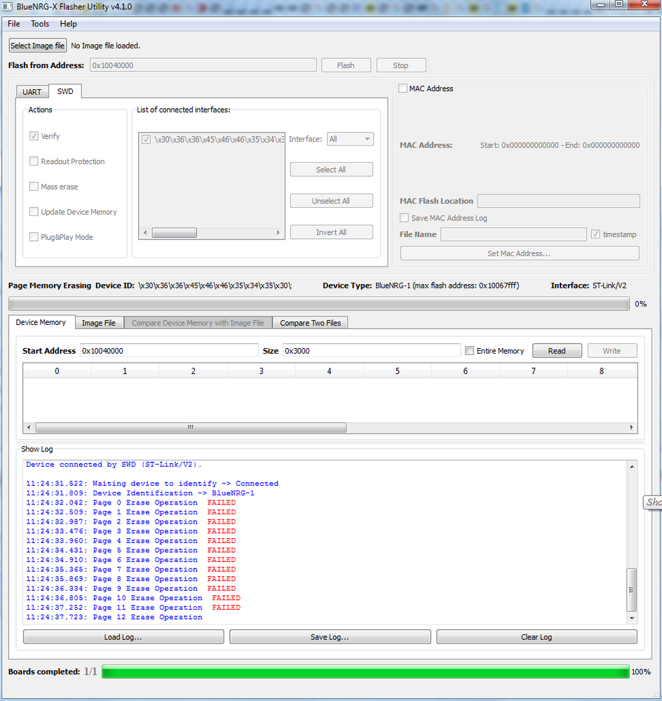

Thanks for the response. I tried to erase it with Keil and BLUENRG-X Flasher, it says that it erased successfully, but it still can't be read
0693W000007DEXrQAO.pngBesides, if I try to erase by pages, it fails, so I believe it can't actually erase the chipI've also tried resetting with BOOT in high, but there were no differences so far
