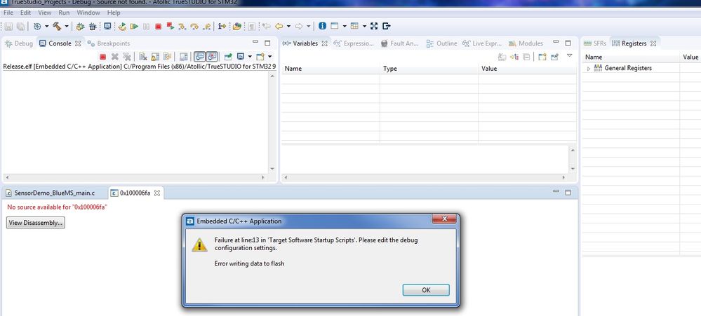

Hi All,
Please help I'm stuck with this, I am currently having some difficulties while programming and debugging the BlueNRG-2 ''STEVAL-IDB008V2'' over STLink/v2.
PROBLEM FACED : When trying to debug and flash the code using TrueStudio getting following error message
Failure at line:13 in 'Target Software Startup Scripts'. Please edit the debug configuration settings. Error writing data to flash0690X0000060PHjQAM.jpg
Details:
Board : STEVAL-IDB008V2
BlueNRG2 Part Number :[/b] BLE232ES
IDE Version : Version: 9.0.1, Build id: 20180420-1214
Project : Imported from BlueNRG-2 Navigator Examples
Example : BLE_SensorDemo_BlueMSapp
Build Status : Success
Hardware Test : OK - Tested by flashing code using :
1. BlueNRG-2 Navigator over USB-Serial, and
2. BlueNRG-1 ST-Link Utility over STLINK/V2.

Correction : further debug, even IAR would not work running debugger for project "BLE_SensorDemo_BlueMSapp"... Anyone able to get ST release working with debugger ??
Winfred LU
April 29, 2019
Hi Dilbert,
Did you debug with the default DK "BLE_SensorDemo_BlueMSapp" project?
Probably it was because the device entering standby state, which disabled SWD pins (IO9 and IO10).
To recover this situation, the following options are recommended:
1) Disable deep sleep by changing call to BlueNRG_Sleep() as follow:
  • BlueNRG_Sleep(SLEEPMODE_NOTIMER, 0, 0) -—> BlueNRG_Sleep(SLEEPMODE_CPU_HALT, 0, 0);
  • In this mode, CPU will never goes to sleep and debug access is always granted. Application has to be modified and execution time may be different
2) Use a GPIO to wakeup the system and grant access to the debugger. User may need to change the call to BlueNRG_Sleep() as follow:
  • BlueNRG_Sleep(SLEEPMODE_NOTIMER, 0, 0); -—> BlueNRG_Sleep(SLEEPMODE_NOTIMER, WAKEUP_IO13,(WAKEUP_IOx_LOW << WAKEUP_IO13_SHIFT_MASK)); /* Example for wakeup on IO13 low level */
  • When debugger access is wanted, user should force the wakeup I/O (IO13 in the example) low and then use the “Attach to running target�? in the debugger.
Please refer to BlueNRG-1,2 Debugging Tips for more details:
C:\Program%20Files%20(x86)\STMicroelectronics\BlueNRG-1_2%20DK%203.1.0\Docs\BlueNRG-1_Debugging_Guidelines\BlueNRG-1_Debugging_Guidelines.html

Any updates? Just developed a board with bluenrg-232 and after the first programming cycle, i can't program, erase etc anymore.. I use Keil 5, programmed the MCU-s with BlueNRG-1 ST-link utility. Somewhere i read buy a Segger J-link, and it will solve the problem.
Winfred LU
April 29, 2019
Hi Schulcz,
It sounds like the same issue,
that after your firstly programming, the device entered sleep or standby state, which disabled SWD pins (IO9 and IO10).
Could you please try:
  • Put the IO7 pin high and then reset the BlueNRG-1,2 device
This action will make UART bootloader activate and allow you to program again.
The following options are also recommended for debugging:

the funy things is, Segger JLINK EDU works without any tricks, why? It is able to start debuging, no matter of the CPU state. STLINk should be able too.
BR
KWT
Winfred LU
August 14, 2019
Possibly it is because that the Reset pin is controlled properly.
Please refer to Target | Settings | Mode in ST-Link utility,
For the mode "Connect with Pre-Reset", it is useful in many cases like when the target contains a code that disables the JTAG/SWD pins.
