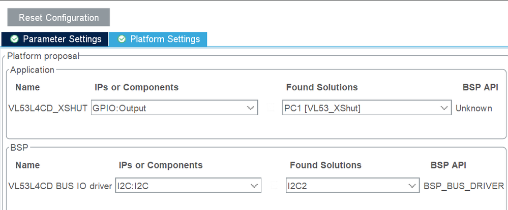

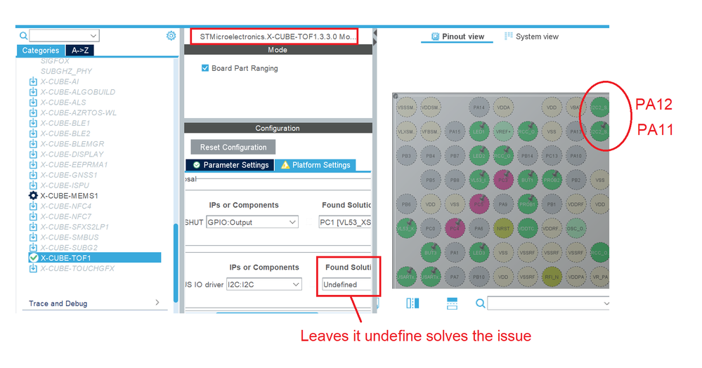

Hello, I noticed that using the X-CUBE-TOF Package with the STM32WL55JC Nucleo-Board has an issue with the I2C-Peripheral(I2C-2).

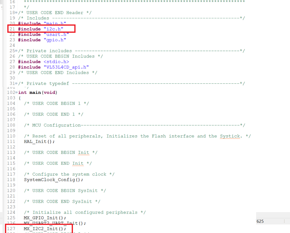

This genrates the I2C code in the IDE.
And the Sensor can be derived.
while if I define the Sensor bus IO:

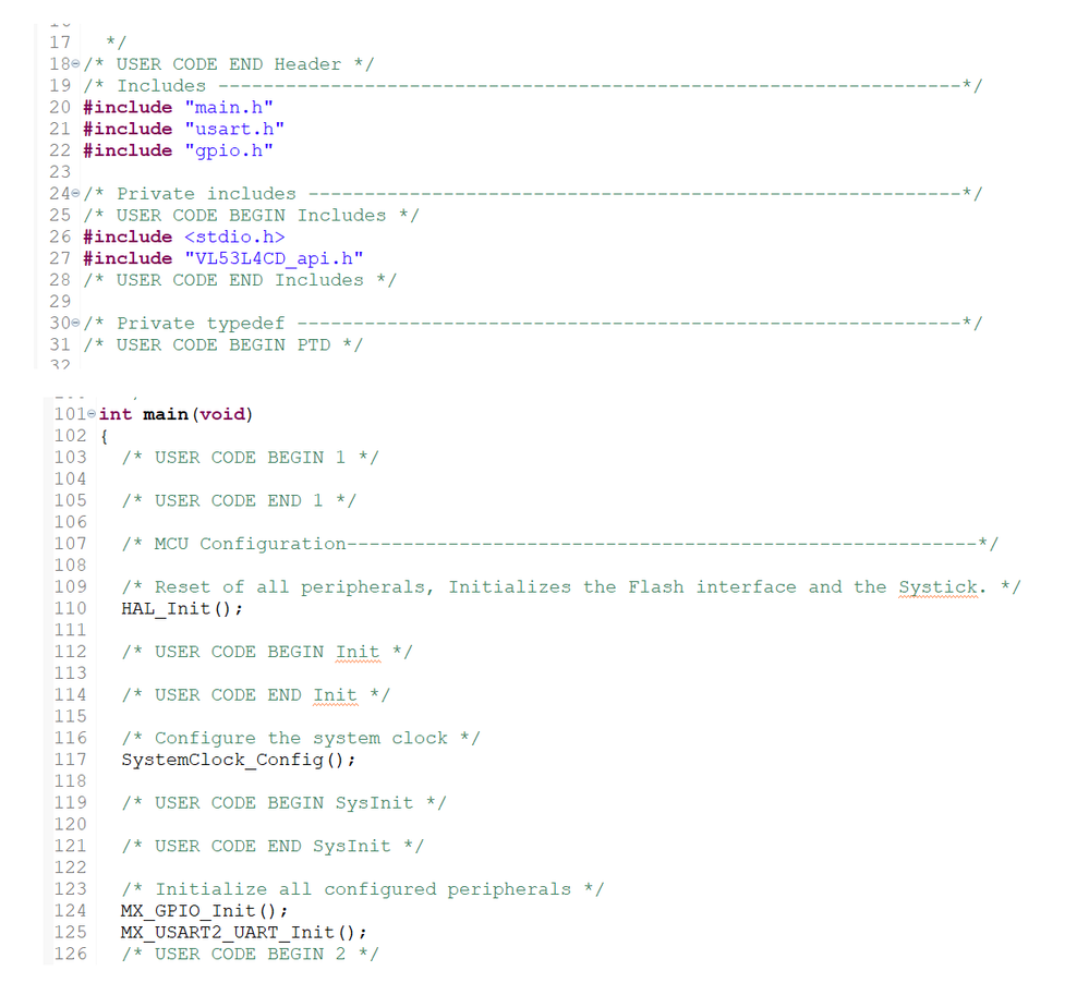

_legacyfs_online_stmicro_images_0693W00000bin7hQAA.pngThe Generated code is without the I2C
And the Sensor is not discovered.
Is that normal? should I define something to make the I2C code get generated or this is a bug in the CUBEMX-Package for ToF?

After a deep check, we find out that when you define I2C2 or any other I2C to be used in the X-Cube-TOF, the I2C code will be generated inside the stm32wlxx_nucleo_bus.c file . And if not, the I2C code get generated in the main.c file.
