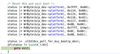

The problem is in function vl53l8cx_init.
There is timeout in various function depending on SPI frequency and apb frequency
timeout can come from this line (325) or from _vl53l8cx_poll_for_mcu_boot function.
Often timeout appear at the third occurrence of _vl53l8cx_poll_for_mcu_boot function.
I'm clearly lost in the search for the causes of this problem. I tried to increase or decrease the SPI frequency but this only change the line where the timeout occurs.

Currently i'm trying with a 2.5 MHZ SPI clock but the init is crashing here :
