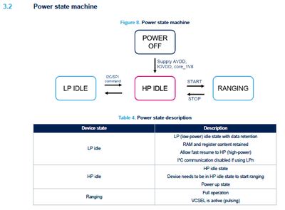

so as described in the datasheet that it can operates in 3 different states:
• Wake-up: The device is set in HP idle (high power), waiting for instructions.
• Sleep: The device is set in LP idle (low power), the low power state. The device cannot be used until set in
wake-up mode. This mode retains the firmware and the configuration.
• Deep sleep: The device is set in ultra-low power. In this mode, the sensor consumes a few microamps of
current. However, the firmware, configuration, and calibration data are completely lost. The user needs to
set the device in wake-up mode and reconfigure the sensor to start streaming.

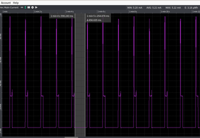

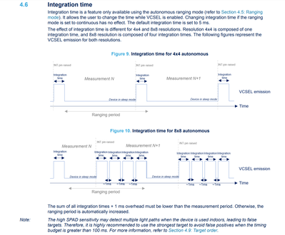

However, I have a question regarding the autonomous mode set to 1 Hz as described in the datasheet. According to the datasheet, between each measurement, the device should be in sleep mode, resulting in an average consumption of around 1.6 mA. However, I am observing an average consumption of 5.21 mA in this mode, as shown in the captures below. Could you please advise if there is a specific method to achieve the expected consumption between measurements?

According to the datasheet, the power states are:
The L5 referenced a Ultra low power idle mode. Perhaps that was what you were looking for.
Between ranges you should be in LP idle state waiting for a command. I believe you can drop the LPn pin to turn off the I2C interface which saves a bit. I did not see in the datasheet if that retains the memory or not. But the chart above seems to indicate that it does. It's not very clear, however.
