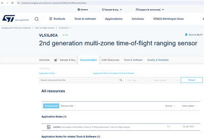

‎2024-02-09 2:23 AM
Indeed no datasheet - just 2 non-specific application notes:
https://www.st.com/en/imaging-and-photonics-solutions/vl53l8ca.html#documentation
:frowning_face:

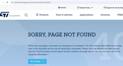

‎2024-02-09 8:11 AM
@John E KVAM - the https://www.st.com/en/imaging-and-photonics-solutions/vl53l8ca.html page now seems to have disappeared - was it not supposed to be public?
