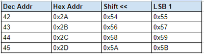

I then changed the I2C addreses for all sensors from the above to be:
sensor_vl53l4cd_sat1.InitSensor(43);
sensor_vl53l4cd_sat2.InitSensor(45);
sensor_vl53l4cd_sat3.InitSensor(47);
sensor_vl53l4cd_sat4.InitSensor(49);
I basically just increased the address by 2 instead of 1 and now both ssensors show different values. How can this be? This is clearly an issue with the sensors and I am pretty sure this is the reason why my code does not work either. I tried to also change the I2C Addresses in my toit code but it was not fixing the problems.

Don't get me started on how bad that I2C bus is, but you found your issue. And it's a sneaky one.
A USB address consists of a 7-bit address and a write/read bit.
At boot the ToF sensors are at address 0x29 - which is the 7-bit number.
To write to the chip, one shifts the 0x29 left by one = 0x52 and then sets the LSB to 0.
To read from the chip, set the LSB to one and you get 0x53.
So, each USB device, has in effect, and address pair.
But it seems silly to keep doing that shift by one all the time, so some drivers reference the chip by its 8-bit address.
Your seeming duality was in fact, just that. Address 0x52 and 0x53 are addresses to the same chip.
And that is why some returned the same number. You were reading the same chip twice.
Sorry I did not spot that sooner. I should have. I've been there; done that.

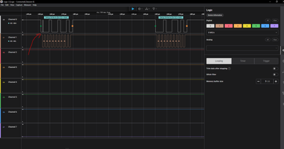

We discovered aglitch yesterday on the data line.
 This should not be there I think. I changed the pull-up resistor on one of the boards to be 4.7k instead of 2.2k and the spike was gone. But also reducing the I2C speed from 400kHz to 300kHz made this spike disappear. Not sure what is causing this spike tho but I think it is coming from the ESP32-S3.
Since then I did not had the problem with a sensor being stuck in the interrupt.

Electrically the board looks fine. I think this is an I2C timing issue because adding 5ms after each i2c write, lowering the communication speed from 400kHz to 300kHz and also wait ~1s after each sensor initialisation seem to help somehow.
Any idea what could cause this on the sensor?
