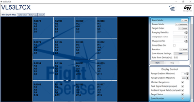

Below is my test result more than 3 meter with 5hz range frequence.
  • R: range distance
  • P: return signal rate
  • A: Ambient level
  • S: Range status
  • Z: Zone number.
