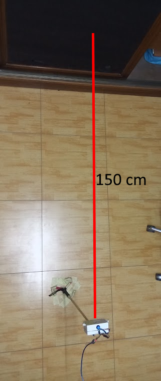

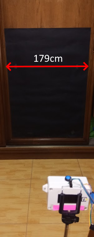

I've tweaked and implemeted the black page (dull to a percent) better than the previous setup (more flat across the page).
So uncalibrated measurements were only down by 1.4% in average, further xTalk calibration has went down to around 121.
What was interesting to note is that by narrowing FOV, the range is overly measured:
The average measurements at 8*8 ROI centered (Long mode, 100ms TB) is 1609.
The average measurements at 4*4 ROI centered (Long mode, 100ms TB) is 1978.
The calibration environment is set as shown in images:
Any hints?

But if you use a narrow FoV, you must set the FoV before your calibrate. (I know, it's a pain.)
The reason you under-range when you narrow the FoV is you get about the same number of photons from the glass, but fewer from the target. This throws off your answer.

I really need to ensure a point: I don't really perform any kind of calibration set after changing FoV, Should I perform it? (offset calibration, calibration of xTalk with uncalibrated offset returned xTalk of zero (0), as it over-ranges)
I'd like to mention that without performing the calibration, I get 'over-range' not vise-versa (160cm 8*8, 198cm 4*4), seems strange really, but this is the observation.

Notes: Coverglasses are always recommended. Unless you are in a lab setting. Reducing the FoV is a good idea, but it does limit the ranging distance.
Water is a difficult problem. If you can 'see' a reflective bottom, then you will overrange. Only solution is to carefully create a look up table. You hvae to compensate for the photons that are slowed by the water and reflect off the bottom.
If you under-range, it's a crosstalk problem. If you over-range, you are 'seeing' the bottom.
If you change the FoV, you really should load the crosstalk calculation you did with that FoV.
Each different FoV should have it's own Xtalk calibration.
Or you could use the crosstalk free coverglass.
If this or any post solves your issue, please mark them as 'Accept as Solution' It really helps. And if you notice anything wrong do not hesitate to 'Report Inappropriate Content'. Someone will review it.
Hi John, sorry again for incomplete statement.
The over-ranging with narrow FoV is observed at lab setting shared earlier. so there's no real thing it can see further 150 cm, I've made sure that the sensor faces the center of the black paper.
I'll try a cardboard instead and I will share updates soon.
