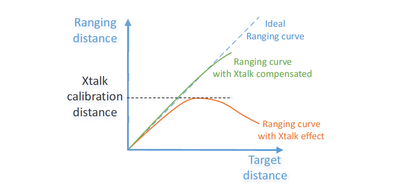

There are three ways the sensor can range 'short'. One is offset - where every range is short (or long) by some constant value.
The other is a crosstalk issue where some target is at about the right distance when the target is close, but as the target gets farther and farther away, the distance gets shorter and shorter.

Is there a way to remove crosstalk calibration completely as there is no glass in front?
With no glass, you should have no crosstalk. and by default, there is NO crosstalk set.
Find a target where the range is 10-20% short and find the real distance.
Then do the crosstalk calibration.
That will tell you how bad things are.

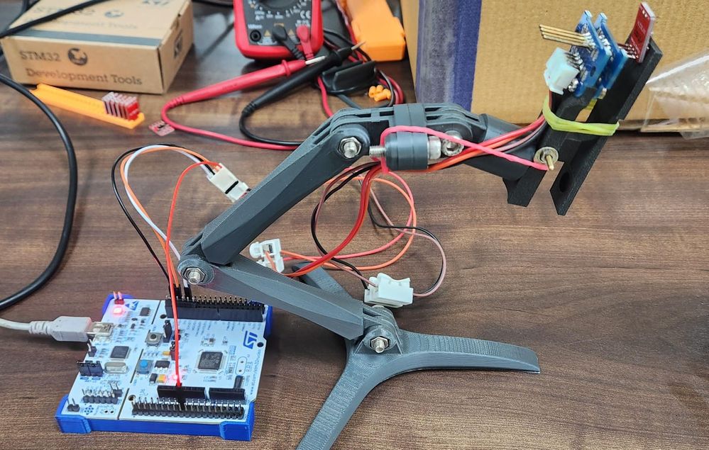

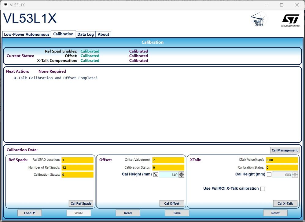

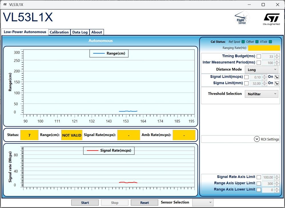

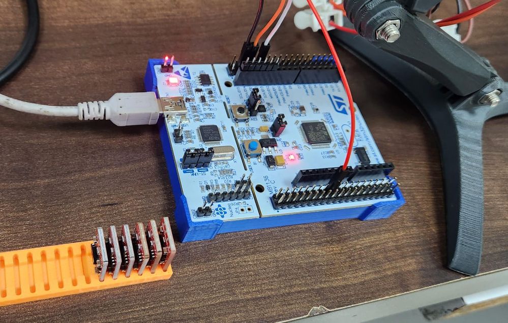

I went through various of your replies to people having issues with this sensor and decided to try recalibration with ST's software. I hooked it up to a Nucleo board and recalibrated in a dark box with the sensor at 140mm from a 17% gray sheet as recommended in the manual.
Please advise on the correct calibration procedure in case I am doing something incorrectly. I have attached photos of the setup and software screenshot.
What I have noticed is that that the sensor can detect a white sheet at 50cm in Short mode, 30 cm in Medium Mode and 18cm in Long mode. I find this very strange, perhaps this could shed some light on what's going on?
Q: Does the sensor need a calibration in 3 modes separately?

John E KVAM
Use white paper at 140 cm to do the offset correction.
Use the dark gray or black to do the crosstalk correction. Distance is highly dependent on your coverglass. Do some experiments - range until you find that place where you are under-ranging by 10 or 20%. Then do the crosstalk from that distance.
In your case without a coverglass you should not have anywhere you are under-ranging. If you do, your sensor has an issue.

spiralbrain
Tried all that you suggested.
The Range is still the same, no improvement. Found one in the lot with the KAPTON still on, removed it and this again detects a white sheet up to 60cm in short mode, 33cm in medium mode and  17cm in Long mode. So its not the glass or the tape.

Is your sensor installed - or out in the open?
in your picture, could it be that the black object be covering part of the Field of view?
Re-adjust the sensor so that black bit is well away from the sensor. The light goes out in a code of 27 degrees, but there is roll-off at the edges. Perhaps that holder is reflecting and making a mess.
