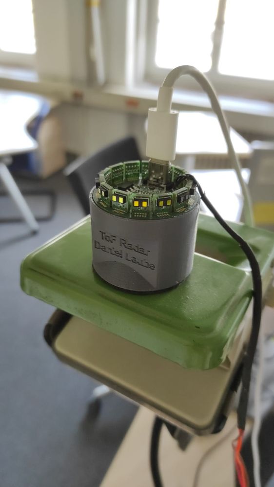

I designed a sensor array containing multiple VL53L1CB sensors. They are configured to scan a 3x3 grid inside its view with multizone scanning. That works great at small distances but suffer a distances above ~1,5m.
Experimentation shows that the sensor never yield reliable results (even with 16x16 zone, 550ms budget, completely dark room with covers down, target is a white wall which should cover the entire FoV) above 2m.
Another issue is the flickering of datapoints. The video shows the issue: VL53L1CB Flickering issue - YouTube
Points in green are valid ranging results (RangeStatus = 0), cyan means RangeStatus = 14 and black is RangeStatus = 7.
The issue is that ranging results cycle through "Not Present", "VL53L1_RANGESTATUS_WRAP_TARGET_FAIL" and "VL53L1_RANGESTATUS_RANGE_INVALID"
even though the RANGE_INVALID is not realy invalid. It is exactly where i think it should measure.

Here is the physical sensor layout, there are 14 sensors in a circle, so they are not overlapping that much.
The flickering and ranging issue persist, even if there is only one sensor ranging. The ROI setup is like this, they are overlapping. In the example video they are all ranging simultaneously, but only running one does not make a difference.

ambient noise seems a bit better but still no valid range measurement. The target is indeed approx 3,5m as shown in some readings (white wall), but the datat points flicker as well (like in the video)

It is odd that your SPAD count goes form 51 to 5.
Do you get 'flicker' if you only consider the ranges that have a RangeStatus = 0?
Knowning the RangeStatus is the best way to figuring out what is going wrong.
With a target a 3.5M, you will never see anything with only 5 effetive SPADS. - So use the RangeStatus to discard that data point. It's not valid.
status =255 means "no chance of a target".
status=7 says we think you have "Radar Aliasing" - which you have to google. It's very interesting.
Range 4 means the phase is out of bounds.
But basically we don't have enough photons to give you a reliable answer.
But here's what is going on.
We claim we can see 4M in pretty ideal conditions with all the SPADS turned on. But by limiting the number of SPADS you will limit the max distance.
Somewhere in the data sheet it talks about 8M - but for that you need a very reflective target - like a projector screen.
You've pretty much proven by experiment that given your number of SPADS, the max distance is about 3M - maybe a touch less.
there are about 200 effective SPADs. (256 real SPADS, but some are deliberately occuluded so we can handle extremely high light conditions), and you've limited them to about 1/4. it stands to reason that you are not going to get the max distance.
So I believe you are simply beyond the max capabiities of the device.
If this or any post solves your issue, please mark them as 'Accept as Solution' It really helps. And if you notice anything wrong do not hesitate to 'Report Inappropriate Content'. Someone will review it.
‎2021-04-29 8:38 AM
Perhaps i get something wrong but the numbrr of spads should not be changing when ​using the same ROI. About 50 spads for a 8x8 seems reasonable when there are 200 spads in total.
But periodic changing to 5 spads is very odd.
Do you know any reason why there are sometimes only 5 spads?
The flickering behaves the same when only using​ rangestatus = 0 readings. The video shows the rangestatus (indicated by color, green is RangeStatus = 0, cyan means RangeStatus = 14 and black is RangeStatus = 7. Other colors represent other RangeStatus values but they are not part of the flickering issue.
Dont get me wrong, i did not expect a range results up to 8m using when using a smaller ROI, but i kind of expected stable results < 4m for things like walls.
I can arrange myself with the "low" distance, but no reliable results (espacially such flickering/waving motion, indication that every second measurement is invalid) seems very odd to me.
