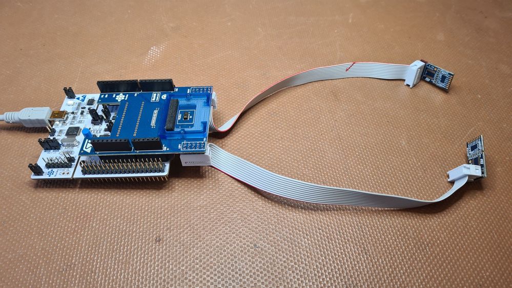

I am using the VL53L1 Nucleo Pac with the Flight Sense GUI supplied by ST. I am trying to evaluate different ROI settings but everytime I change the ROI, all the calibration settings seem to be cleared. Can one change the ROI in the GUI without resetting all the calibration values?
