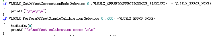

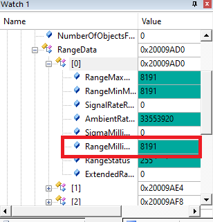

Vl53l3CX works well when i init it with DataInit and StartMeasurement Function,but when i add a OffsetCalibration to its init sequence,it output a distance of 8191 mm,which is obviously wrong .Paraments of calabration function are shown in the following picture,is there anything wrong.any advice will be appreciated.

the rangestatus of the first measurement is always 255,use VL53LX_ClearInterruptAndStartMeasurement function get
next normal measurement.
