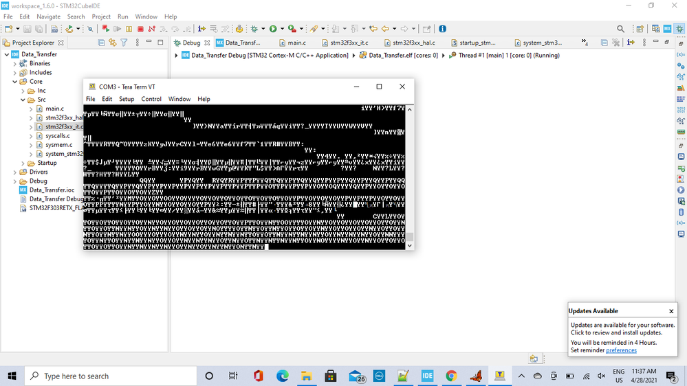

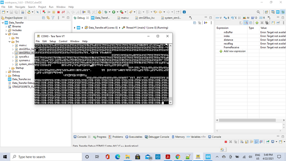

Hi there,
I am working with tfmini lidar and i am using USART3.However i am getting the garbage in the virtual port any idea how can i resolve this but i am getting the right header i.e YY in decimal.
Any suggestion would be appreciated.
Thanks

‎2021-04-28 8:08 AM
Hi John.
The baud rate that i'm using with lidar is 115200 (i'm using UART3 to connect lidar and st board)since lidar works on this baud rate as mentioned in its data sheet and i'm printing this data to vcp at the rate of 9600(on UART2).would this be a problem?(if this is the problem how to solve this since st-link is connected to UART2 which is always programmed to work on 9600).

‎2021-04-28 8:43 AM
hi john,
i tried both 460800 and 921600 but i was getting garbage data(After upgrading to the st-link firmware) i was still getting the garbage and when i changed UART2 to 9600.i was getting some readable data but not until when i started waving my hand in front of lidar.Here is the picture attached below.
and yes I am using CubeMx ;)
‎2021-04-28 9:27 AM
What are you expecting here? Numbers in ASCII?
The data packets returned have binary data in them, not really designed to be human-readable at the terminal console.
‎2021-04-28 10:21 AM
Yes i am expecting ascii.i am printing the data same as i got from lidar.
i'm assuming the data is coming in ascii.since header 'Y' is printing this way.i want to change them to binary format after to do some useful with them.
