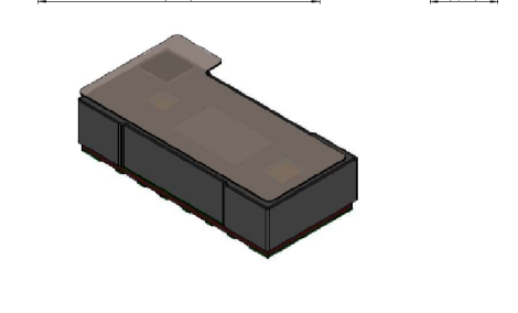

Thank you for your reply.
I mean the little foile on top of the VL53L5CX like in the picture below.
kind regards
This liner is put to protect the sensor from soldering.
To use the sensor, you have to remove the liner. If you use the sensor with it, it explains your  faulty measurements.

Thank you for your reply,
so in this case i can use it safe without this protect foile?
Kind regards
Maik H
Yes that's safe. No worry.
