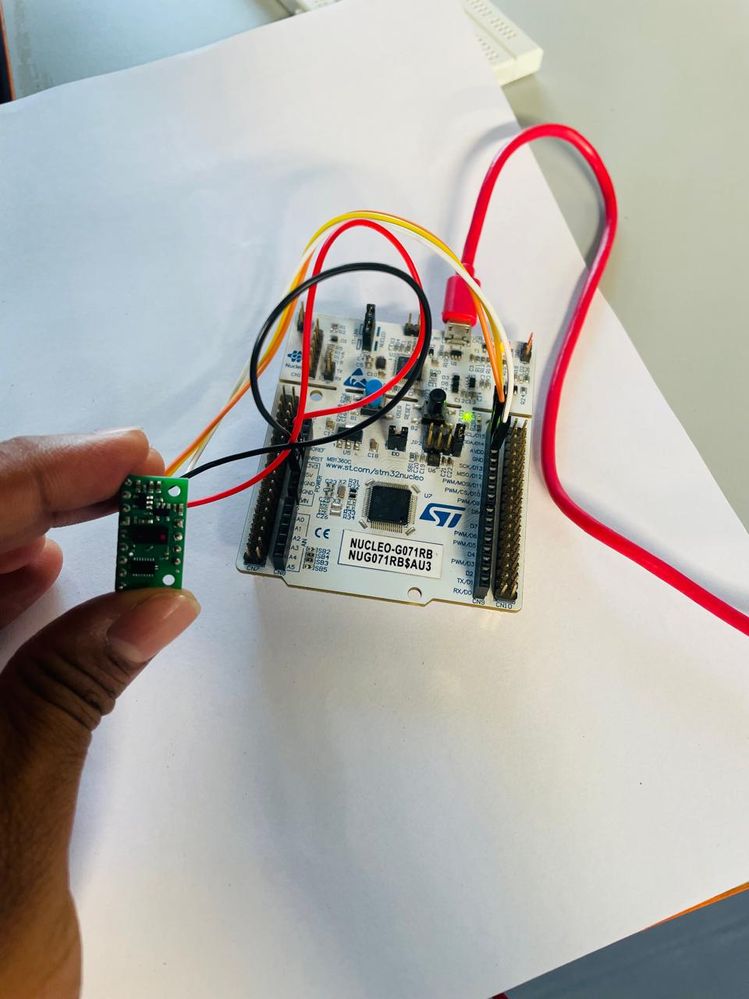

Yaa, i am checking the ULD provided in (https://www.st.com/en/embedded-software/stsw-img040.html) and, i am referring the (Example_1_ranging_basic) code. As i am new the STM Cube IDE and its programming environment, i am unable to see any output in the console.
Hi Andrew Neil,

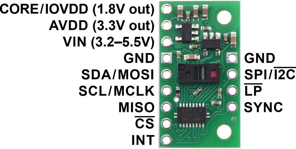

As i am referring to the support material, i am unable to build/generate the main.c code required for testing the TOF sensor connected with Nucleo-G071RB. Refer attached image. I am using following pin connection -
1. VIN of TOF -> 3.3V of Nucleo-G071RB
2. GND of TOF -> GND of Nucleo-G071RB
3.  SDA, SCL of TOF -> SDA(D14)/SCL(D15) of Nucleo-G071RB
4. SPI_I2C_N  of TOF -> GND of Nucleo-G071RB as (driving it low selects I²C mode)
