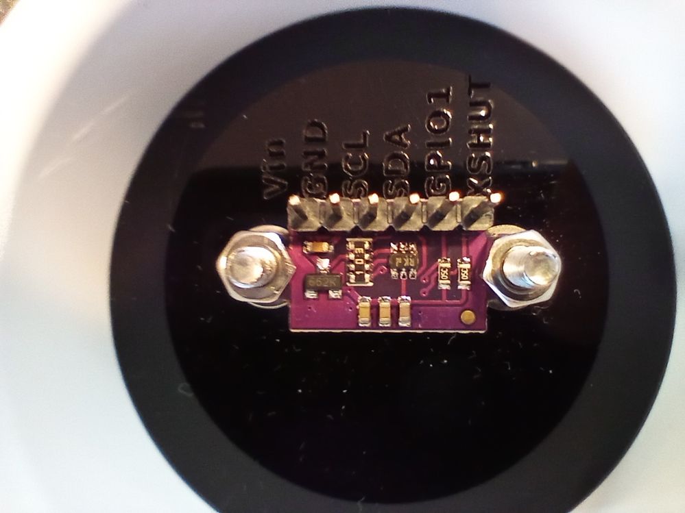

The L0X is installed in a ~half full steel 275V oil tank with zero ambient light and it has a cover with cross talk barrier.
I know that the 4CD would probably be better, and I am experimenting with at present, but the availability of breakout configurations is much more limited so that will be a mechanical problem.

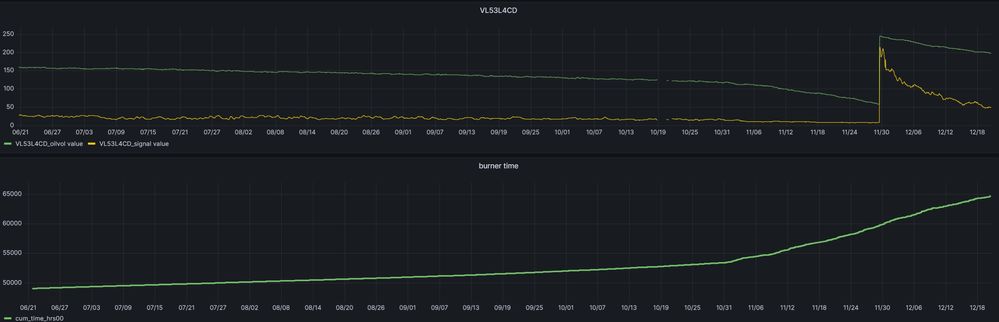

Just a 6 month follow up.  Bottom graph is oil burner run time hours in 100ths.  Total 157 hours over the period.   The top graph is the VL53LCD distance measurement converted to gal remaining(green) and the "signal" measurement(yellow).  There was a 177 gal fill on 11/29.  Total consumed over the period 138 gal.  Works out to 0.88 GPH.  It's a 0.85 GPH (marked) nozzle.
At fill time I ordered 185gal based on the data and the tank took 177.  There's some subjectivity in guessing when he's going to show up on my end and on the driver's end when the whistle stops and he shuts off the pump.  It's all close enough for me.  The signal level minima was 7-8 when the level was as low (measured distance was at its maximum) as I ever want it to be.  So all good.  I did have one mid-october system hang.  I don't remember what it was but it was not sensor related and easy to fix with a reboot of something.  I've got these VL53L4CDs on three tanks now with AliExpress covers (literally $1.50@) running on ESP8266s and they all work great.

I would really like to use the 4CD because of the FOV angle because the tank has a curved bottom. The narrower angle will get me closer to the bottom before picking up returns from the sides. I can't figure out a good and simple way to mount your hole-less breakout board with the 4CD. Right now I am using the Chinese L0X boards that have the 2mm holes on either end and room for the Hornix cover screw-mounted to a 3mm thick black acrylic sheet, laser cut for the 2mm holes and the cover oval. That mount plate is then glued into a PVC adapter with pipe thread for the tank fitting. Unfortunately the guys in China haven't picked up on the 4CD part yet, as far as I can tell.

And I do like your design. I've seen other designs that used a flat board connected the sensor and then they filled the structure with potting material. Makes it water-proof. Althougth once done, there is no changing it.

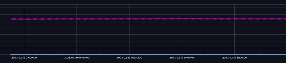

I now filter the data and exclude any points out of valid physical range and the problem is gone. I also keep track of the number of bad points on each read cycle as a measure of if and by how much the signal returns are deteriorating. The magenta (below) is the oil volume in the tank and the two little blips on the blue line are one bad data point each, diring those two read cycles(out of about 300). Now they are not summed in nor is their index value added to the divisor. No impact now on the published result, but this IS what WAS generating the offset-to-a-higher-value data lines.
