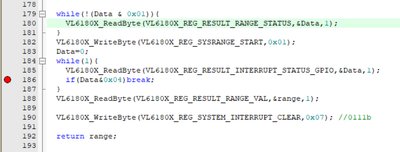

hi:
I am also stuck in the following function. Reading other registers that have already been written is normal, but it cannot be done after starting the conversion. VDD is using 2.8V and has replaced many settings, but it does not work. I don't know where else to pay attention to, please advise.
October 20, 2023
hello, did you solved your problem yet?
I think I'm encountering the same problem, all the  init register is correctly
but it always wait at VL6180X_REG_RESULT_INTERRUPT_STATUS_GPIO  here :
while(!(VL6180X_ReadByte(VL6180X_REG_RESULT_INTERRUPT_STATUS_GPIO)&0x04));

I think you are using the wrong register. If you set a threshold, you use that register, but without a threshold one would use the SYSTEM__INTERRUPT_CONFIG_GPIO register.
That same bit in this register should give you the interrupt when you do not have thresholds.

i use the same code with stm32f103 ,is all correct, but when use  the  other 8051, it always wait at while(!(VL6180X_ReadByte(VL6180X_REG_RESULT_INTERRUPT_STATUS_GPIO)&0x04));
But I found it can pass when my hands touch the board in a few times,
I have noticed the level conversion , and the init code is all correct, ,I check it with oscilloscope
the problem iis like LDe P.1 said :when I  start a single shot reading, but i always get DataNotReady.

Hi QZH,
As I see you are using 8051, so I suspect this is due to I2C community issue. 6180 device register is 16bit long and data is 8bit long, please double check this point from your side.
Br
