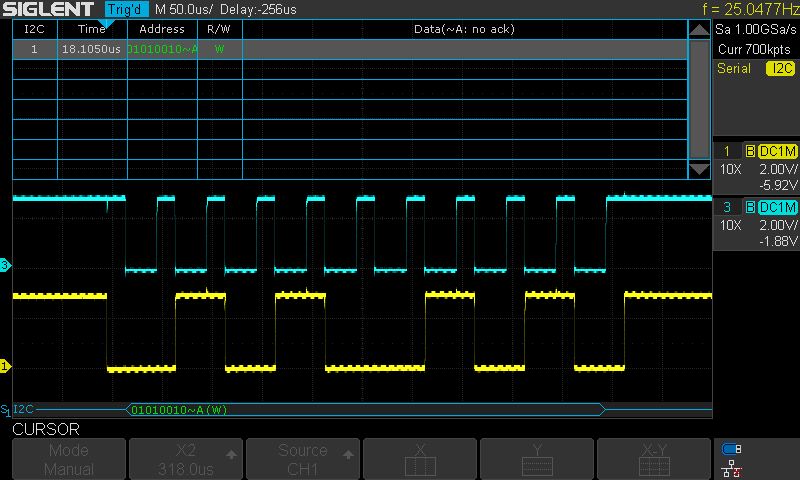

i am trying to get STM32F301K8 to communicate with VL6180V1 ToF sensor on my custom board., via I2C (at 20kHz) I had problem getting the API to work so i tried low level I2C access by just sending 0x01 with basic HAL_I2C_Master_Transmit.

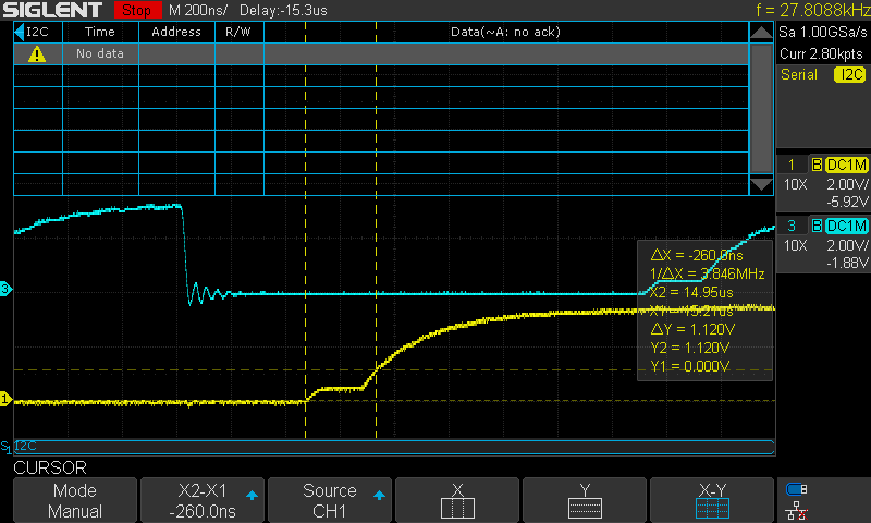

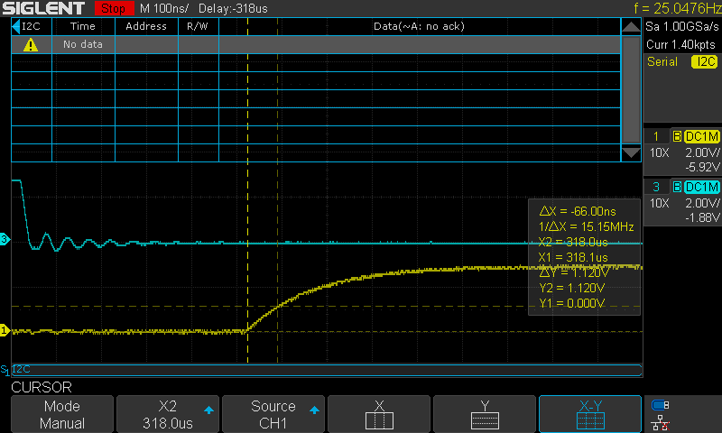

I noticed that i can not get ToF sensor to respond with ACK. I checked rise times of the I2C, it is 66ns, due to my long traces, but still well under maximum of 120ns, according to datasheet. I am using default ToF 7bit address of 0x29 (and left shifting it << 1) and on scope it is clearly visible, along with RW bit. Also start and stop conditions are looking as they should, so only problem is the missing ACK. I also tried on 2 different PCBs with fresh out of reel ToFs. Pullup resistors are 4.7k (also tried with 1k) and Vcc is 2.82V.
Could it be that ToFs are faulty or i destroyed them when soldering?
Scope picture of rise time measurement and the I2C master transmit signal are below:

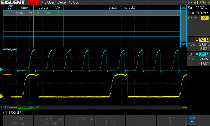

Below are readings from X-Nucleo-6180A1 development kit:

Thank you for response. There are no wires, just trace on the pcb, which i cant shorten. Their length is 85.9mm(SDA) and 86,4mm(SCL). Will check NXPs documentation.
Yes, i am using STMCUBEMX plug in for CubeIDE to setup my code and design system. I also tried my code on the development kit and it worked there(with few modifications because of gpio extender that is used there).
