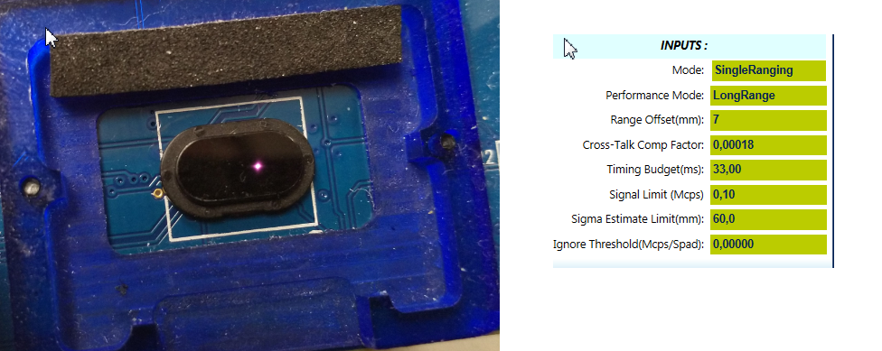

Then, I placed the SAME sensor cover on X-NUCLEO-53L0A1 and used VL53L0X GUI from ST to calibrate the NUCLEO's sensor: It worked really well (offset = 7mm and xtalk = 0.00018).

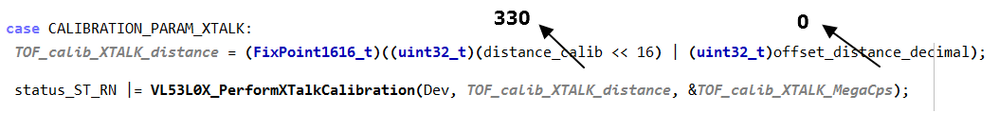

Seeing this, now I think the problem is in my code. Could you please help me understand how the function VL53L0X_PerformXTalkCalibration works?
1) XTalkCalDistance is FIXPOINT1616. If I want to tell the sensor the xtalk calibration distance is 330mm, is this ok?
2) pXTalkCompensationRateMegaCps is FIXPOINT1616. During my last attemp VL53L0X_PerformXTalkCalibration returned the value 24320. How can I interpret it?
  • 24320 Megacps (0101 1111 0000 0000)
  • 0.24320 Megacps (000000000000000 0101111100000000)
  • Other

Julien NGUYEN
​Hi,
What is the size of the target you were using to perform the crosstalk calibration. You need a 1mx1m grey target.
If the target is a card, it is too small, depending on the distance, the target will not cover the full FoV of the sensor, and then there is no enough photons coming back from the target, the photons coming back from the cover glass become very quickly dominant which makes you believe that the measured distance starts to deviate at 150 mm, but in reality it should be longer (~60 cm or more).  Please use a bigger 1mx1m target if it is not already the case. Thanks, Julien
John E KVAM
The classic problem with crosstalk is that it causes your system to UNDER-range. Meaning all your numbers are too small. But you are OVER-ranging.
5) Ranging. When an object is located at a distance of:
  • 50 mm --> Sensor measures 55 mm
  • 80 mm --> Sensor measures 100 mm
  • 110 mm --> Sensor measures 210 mm
  • 150 mm --> Sensor measures 8191mm (0x1FFF, no object detected)
That means your crosstalk is too high.
Try this experiment...
Run your calibration and click the 'save' button.
Go to the Log page and click on File1 - we are just trying to find where the calibration files are.
Find a .txt file that contains the calibration data.
It will be in a directory such as:
C:\Users\YOURNAME\AppData\Local\STMicroElectronics\VL53L0X\VL53L0X_StateDataIni.txt
have a look at that.
Mine looks like the following:
[Version Info]
VERSION=1.0.0.0
DEVICE_ID=1.1
[Ranging Settings]
SIGNAL_RATE_XTALK_COMP_MCPS=0.01860046
SIGNAL_RATE_XTALK_COMP_MCPS_APPLY=True
PT_TO_PT_RANGE_OFFSET_MM=7
PT_TO_PT_RANGE_OFFSET_MM_APPLY=True
XTALK_CALIBRATED=True
OFFSET_CALIBRATED=True
XTALK_CALIBRATED_MANUAL=False
OFFSET_CALIBRATED_MANUAL=False
SNR_LIMIT_CHECK_ON=False
SIGNAL_LIMIT_CHECK_ON=True
SIGMA_LIMIT_CHECK_ON=True
XTALK_CORRECTION_ON=True
SNR_LIMIT=0
SNR_LIMIT_APPLY=False
SIGNAL_RATE_LIMIT_MCPS=0.1000061
SIGNAL_RATE_LIMIT_MCPS_APPLY=True
SIGMA_ESTIMATE_LIMIT_MM=32
SIGMA_ESTIMATE_LIMIT_MM_APPLY=True
TIMING_BUDGET_MS=20
TIMING_BUDGET_MS_APPLY=True
INTER_MEASUREMENT_PERIOD_MS=300
INTER_MEASUREMENT_PERIOD_MS_APPLY=True
XTALK_AUTOCAL_TIME_PERIOD_SECS=30
XTALK_AUTOCAL_TIME_PERIOD_SECS_APPLY=False
XTALK_COMP_LIMIT_MCPS_PER_SPAD=0.05
XTALK_COMP_LIMIT_MCPS_PER_SPAD_APPLY=False
MSRC_ON=False
DSS_ON=True
TCC_ON=False
PRE_RANGE_ON=True
MSRC_TIMEOUT_MS=2.058594
MSRC_TIMEOUT_MS_APPLY=False
PRE_RANGE_TIMEOUT_MS=8.03125
PRE_RANGE_TIMEOUT_MS_APPLY=False
PRE_RANGE_VCSEL_PERIOD_PCLKS=14
PRE_RANGE_VCSEL_PERIOD_PCLKS_APPLY=True
FINAL_RANGE_VCSEL_PERIOD_PCLKS=10
FINAL_RANGE_VCSEL_PERIOD_PCLKS_APPLY=True
[Comms]
I2C_SPEED_KHZ=400
I2C_SPEED_KHZ_APPLY=False
[DISPLAY]
RANGE_DISPLAY_UPPER=10
RANGE_DISPLAY_UPPER_APPLY=True
RANGE_DISPLAY_LOWER=0
RANGE_DISPLAY_LOWER_APPLY=False
SIGNAL_RATE_DISPLAY_UPPER=80
SIGNAL_RATE_DISPLAY_UPPER_APPLY=False
SIGNAL_RATE_DISPLAY_LOWER=0
SIGNAL_RATE_DISPLAY_LOWER_APPLY=False
DISPLAY_PLOT_SAMPLES=50
DISPLAY_PLOT_SAMPLES_APPLY=False
RANGE_STATS_FILTER_SIZE=20
RANGE_STATS_FILTER_SIZE_APPLY=False
[DATA_LOG]
DATA_LOG_SAMPLES=0
DATA_LOG_SAMPLES_APPLY=False
Reduce the number in the line:
SIGNAL_RATE_XTALK_COMP_MCPS=0.01860046 (this is my value - yours will be different)
and save the file
CLOSE THE GUI and run it again. This clears out the old data.)
Go to the calibration page and verify you have the crosstalk number you put in.
Do some ranges.
Repeat this process until you are convinced you are getting correct distances. (Over-ranging means your number is too large, Under-ranging means it's too small.)
Now we know the right crosstalk value.
So let's try to find out why your crosstalk was wrong when you did it.
In Julien's reply, he suggests you need a larger target. The target must half as wide as the distance to your sensor. So if you do your crosstalk at 1M, your target must 0.5 meters square.
(A 1m square target can be hard to come by.)
Finding the right distance can be hard. To do this, go to the calibration page and hit RESET. This insures you are not double calibrating. Then do the offset calibration.
Go back to ranging. Find a target and distance were you are under-ranging by 20 or 30 percent.
Then do your crosstalk cal. Did you get the number you know to be right?
If not, try a different distance, or a different target. Keep in mind the size.
good luck
