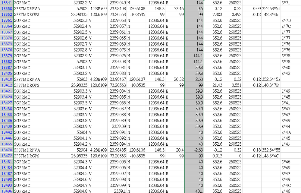

The new file is the data collected on the train passing through a long tunnel.
I have been looking at the log and see the drop in speed that you mentioned.
However I noticed that in the log you provided where the speed drops, the message output is also different.
Did you change the NMEA and ST proprietary messages that are being output for the test run that worked well compared to the test run that is giving this bad result?
I am uploading the spreadsheet of 26_06 log, please have a look.
You will see that in 26_05 log, GPRMC and PSTMDRPVA is being output at the same rate. However in the previous log I shared where it worked well, it looks like PSTMDRPVA and PSTMDRGPS are output at 1 Hz while GPRMC is output at 10 Hz. Could you please revert to this configuration?

Regarding log, it was my mistake, when filtering the data I accidentally pasted the wrong column in my comparison.
So I had a chance to look at your data, the speed output and also the accelerometer output.
As indicated during the time when DR showed a speed of 0, the accelerometer also was showing ~0 values indicating the vehicle was not in motion.
I discussed this our R&D team and they indicated couple of considerations,
1. You mentioned you calibrate this in a car and then put the calibrated unit on a train. In this specific case for your testing, the calibration values were almost similar when placed in a car and train, therefore VIC3DA worked. However we cannot guarantee this will be the case for all units that is calibrated in such a way. This can result in some units in the field not being calibrated.
2. VIC3DA is primarily intended for automobile applications and not really for train. The vibrations of a train will be different than a car and this could be the reason why VIC3DA misinterpreted the speed value.
I have forwarded your case to your marketing team. Meanwhile, can you also please get in touch with your local ST sales/distributor team and initiate discussion. They can guide with the right solution.
Attached is result of my analysis for your reference. You can refer to timestamp of ~52900.
