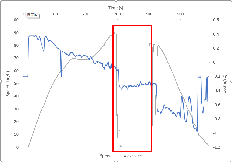

Hi @GalaxyQuest
Sorry for late response. I have done some test.
I use DRUM mode, and I checked PSTMDR2 with "CC" flag. So the DR mode was ready.
Sometimes I got good result (<50 m error between DR last estimate position and GPS position after driving through a tunnel).
But sometimes the speed estimated by DR would suddenly drop to 0 after I entered the tunnel (and the actual speed was around 80-90 km/h). The flag from PSTMDR2 was still "CC". Seems the DR mode was still working, but it give the wrong data.
Speed data and X axis acc data are the following: (red box is the data when I entered the tunnel)螢幕擷取畫面 2025-05-29 112421.png
I had placed the VIC3DA on a heavy steel plate and tight it with seat belt. It may not have relative movement.
Are there someting I misunderstood?
Thank you.
Can you please provide me what version of firmware you are using in VIC3DA?
Can you please provide a log - if this log includes when the speed in tunnel is normal and when speed in tunnel drops to 0, that would be helpful.
Could you please let me know what $PSTMDRPVA reports when speed drops to 0?

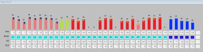

In addition to my above message, could you please let me know how the antenna is placed?
The reason I am saying is during the initial part of the run when you are in open sky, the signal levels are not that great. In open sky, you would except CN0 of the signals to be ~45 db-Hz while most of your signals are in 30s and 20s.
