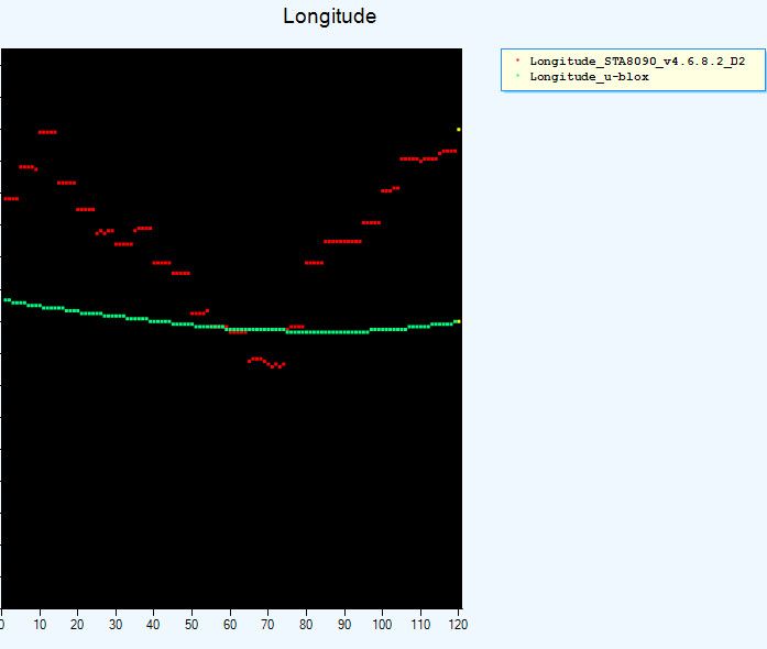

Hi! Why are the coordinates (latitude and longitude) of the Teseo-LIV3F changing abruptly and not smoothly like the u-blox M8 and NV08? Smooth change of coordinates is very important to me, since the direction angle is calculated in our program precisely

Hi
Turned off the Stop Detection algorithm in the CDB-200 bit [15] - the end result has not changed, jumps in the track angle are observed. What else can be done?
Just a question looking the image...
Are you comparing devices with the same frequency FIX rate?
Are both the device running at 1 Hz FIX?
Thanks
Regards
Francesco
Hi
I compare devices with the same FIX frequency.
Both devices operate at 4 Hz FIX. Devices work on GPS, Galileo, Beidou.
I did an experiment with your setting and I can see the CPU is 100% of it's time....
In our default CPU runs @ 48Mhz it seems not enough in your setting...
You can increase the CPU speed @ 196MHz with this commands:

I forgot to say, the frequency has already been set to 196 MHz.
ok.
Could you try enabling the walking mode? It 's an optimization in case of low-speed.
