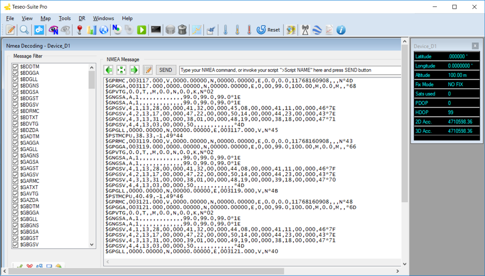

Hello, Can you help me?
I assembled a module on the Teseo-liv3f basis with a passive antenna (A25-4102920-AMT02). And I can not get the coordinates in nmea messages (screenshot in attach). What could be the problem?
Thank you.

Hi Sergei.
Do you have LNA and SAW filter in the RF-path?
Regards
Francesco
Sergei
Francesco,
I do not have an LNA and SAW filter. I use a minimum of connections.
Thank you.
Francesco Virlinzi
​Hi Sergei.
Sorry for the wrong image. I'l take an action to fix the document.
LNA and SAW are strongly suggested as reported in Chapter '6'.
Sorry for the mistake.
Regards
 Francesco
Sergei
Francesco,
quote "Chapter 6.1 A passive antenna can be directly connected to Teseo-LIV3F. Take care that the antenna has to be close to the module...."
What about this? It is also mistake?
Regards
Francesco Virlinzi
Hi Sergei
It seems you are reading an old doc version.
The new one is online @
Regards

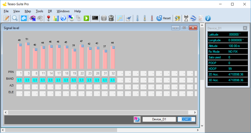

I have the same problem with my Teseo-LIV3F module. It is connected to an active GPS antenna with an external power supply.
I receive several GPS satelliteᅠ with a very good field strength as following picture:
The first time I tested the module, I've got the fix 3D for about 4 hours.
After that, I can't have the fix and I don't have the position:

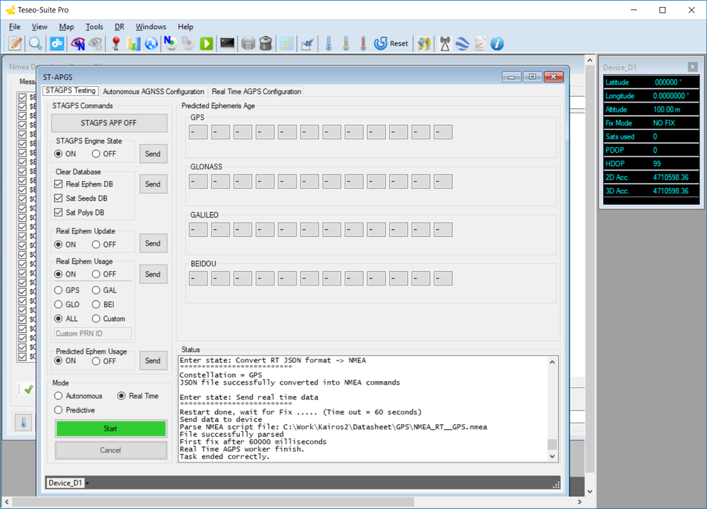

I've tried to update the ephemeris but with no result
In all my tests, only one time I saw one GLONASS satellite for about half an hour.
Can you help me?
Best regards
Francesco
