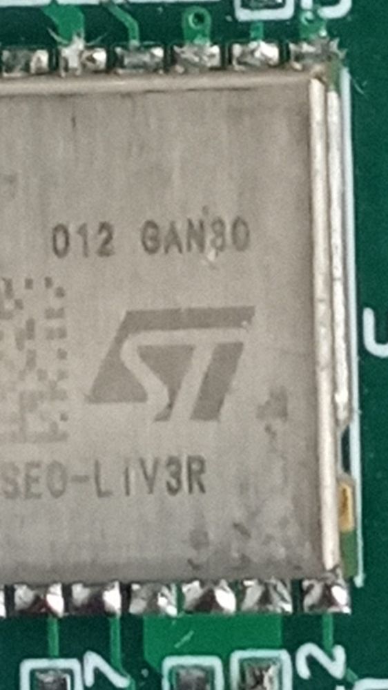

We are having trouble to work with the TESEO-LIV3R
It looks like we have chips that has old firmware
We tried to update the FW using the Teseo-suite Pro
but couldnt manage to do it
As soon as we connect to the Teseo-suite we have connection to the Com port and as soon as we try to upload the Bin file it gives us the massage that it is in Sync and it doesnt proceed from there
Is there any other instruction then that one that is in the ST web site or if you could help me I would appricate that

We have GPS modules with the 0693W00000QKIAwQAP.jpg 012 GAN80
Francesco Virlinzi
Hi
Teseo-LIV3R is a ROM based GNSS module. You can NOT upgrade it.
The module which support firmware upgrade are:
  • Teseo-LIV3F
  • Teseo-LIV3FL
which are both Flash based.
Regards
Francesco
Thank you so much for your answer
I have few Modules Teseo-LIV3F
and I will try to update them
But what can I do with the LIV3R that I bought - why cant I get the Sattelite ( I keep on getting "0" atough the layout is ok ( Tried with few antennas )
What can I do with the LIV3R
Please advise
