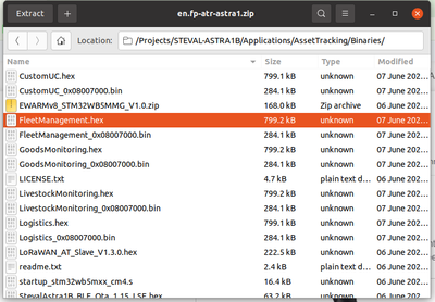

My team also have same issue on this. We would like to try updating ASTRA-1B firmware. We download the firmware zip file from the STEVAL-ASTRA1B product page. Under tools & software tab and under MCU and MPU embedded software section. I download version 2.0.1
After for quite sometimes searching for the firmware. I stumble upon this binaries folder. Which I believe the firmware for STEVAL-ASTRA1B. Is this the firmware that i suppose to upload to STEVAL-ASTRA1B?
This is the firmware binary that needs to be programmed.
en.fp-atr-astra1\Projects\STEVAL-ASTRA1B\Applications\AssetTracking\Binaries

Hii GalaxyQuest,
regarding an update for Steval -Astra1b firmware, which board should I update the firmware on STM32WB5MMG module or the STM32WL55JC module? Plus, which STM32 software is preferred to update the firmware?

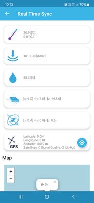

Hi galaxyquest,
I also face the exactly same issue as technofreaks,
My gnss also not receiving any signal from satellites,
I also tried to test it outside with a clear sky view,
And I also programmed the binary (2.0.1 Livestockmonitoring) from the folder.
It didn't fix the issue.
i uploaded a screenshot from the app,
Thank you

Hi
I followed the document instructions but it still doesnt work,
Moreover the bluetooth doesnt show up ( i confirmed that the led indeed blinked as described in the end of this procedure)
I did it a few times to confirm that I didn't miss any step
Thank you
