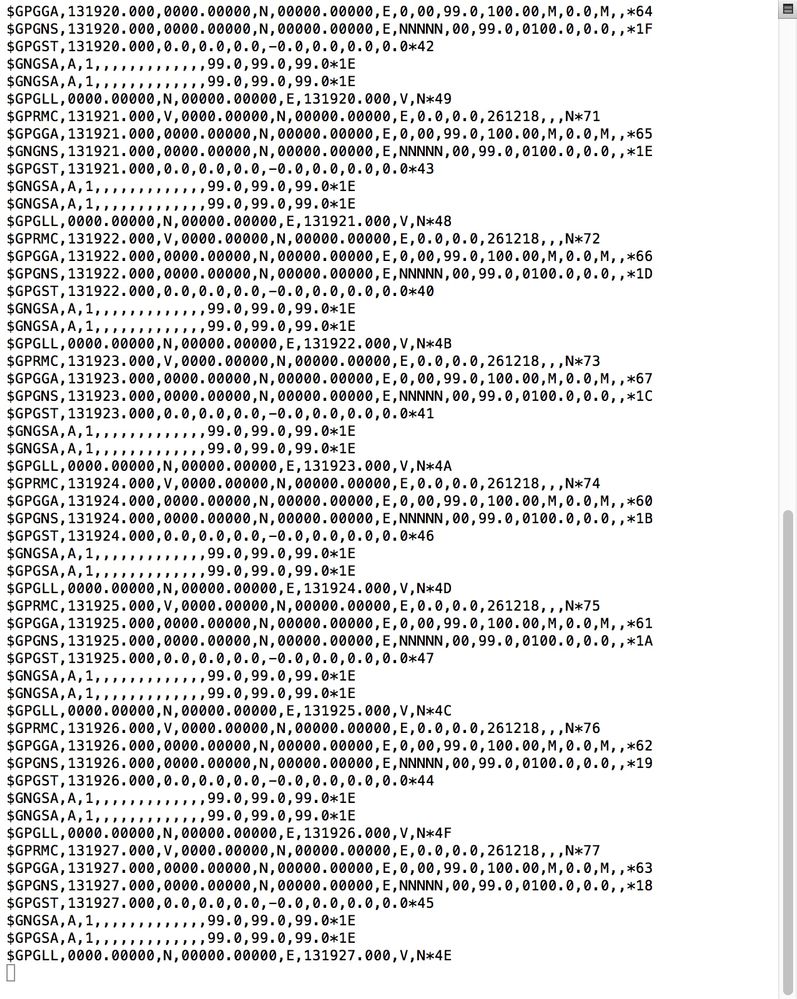

Hi, after playing it for a while, I am able to communicate with the X-NULCEO-GNSS1A1 via USART
But the altitude and longitude are not correct, it is not changing. Not knowing what to do, I decided to perform a cold start by sending the command "$PSTMCOLD, 6", and after doing so, the NMEA messages become all zero
I've tried many commands. Such as reset engine, perform hot start, etc. but no luck.
Any advice or idea will be appreciated, thank you.

Perhaps focus on the RF and Antenna connectivity. Start by having the antenna outside, with a clear view of the sky, best to break the roof line of the surrounding structures.
You will need to see satellites described in the $GxGSV sentences, signals >= 32 dBHz, and at least 4 satellites for a time+position fix.

with $PSTMCOLD, 6 you cleared the ephemeris data which have to be downloaded again from satellited.
Take care that antenna have to be places in out-door. GNSS can not work in in-door

I just did an experiment with '$PMSTCOLD,6' in few minutes I have 16 satellites tracked and the FIX (3D) done.
Test performed with Nucleo-F401RE+X-Nucleo-GNSS1A1+GNSS_Antenna (the same antenna in the X-Nucleo kit)

Thanks for immediate response, I've tested it today, and it works. Really appreciate it.
Hi, thanks for your response, indeed GNSS can not work in in-door. Fortunately, In my case, I am working at out-door. However, it makes the testing relatively time consuming since I need to walk outside every time lol.
