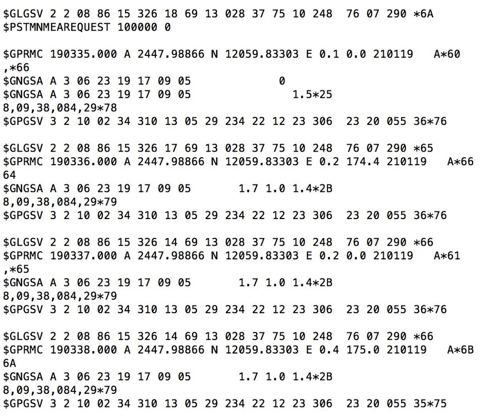

​ 2. After reconfigure the message list by the command "$PSTMCFGMSGL,0,1,0,0" and "$PSTMSAVEPAR", nothing
changed, I'm expecting this since the Baudrate doesn't change immediately, as well. When I request the
message via command $PSTMNMEAREQUEST,100000,0 (GPGLL), I didn't get what I expected, instead, I get this
​Which is totally different from the application note, and I don't know what to do, the manual is rather confusing to me.

PTsen
Hi, the problem still persists
There are few questions I want to ask:
  1. All of the example in software manual is assuming the user is using Teseo-Suite, if not, we should append checksum and cr, lf at the end of the string
  2. Passing the command "$PSTMCFGPORT,0,0,2,38400*4c\r\n" gives me neither "$PSTMCFGPORTOK*45" nor "$PSTMCFGPORTERROR*19", instead, I receive "$PSTMCFGPORT,0,0,2,38400*6c", which has the wrong checksum, what is happening?
Thankyou

PTsen
Hi, I've checked my code, and there is some subtle mistake, resulting in the wrong checksum. Even though it works fine in online compiler.
Thank you really much, really appreciate it.
