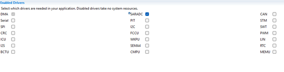

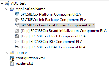

  1. After creating a new SPC5 Application and added every propaedeutic component, click on "SPC58ECxx Low level Drivers Component RLA"
  2. And Check the SARADC Enable box from the "Enabled Drivers" window

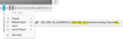

  4. Select the ADC pin you wish to use (i.e. PB1, pin 56) and allocate it.
    When allocating the function (ADC SAR 12bit S) and the CHANNEL (66 in our case) will be shown.

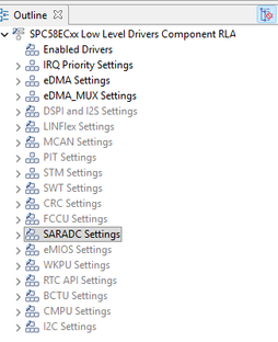

  5. If you miss them, by left clicking once again on the pin you should be able to check the SARADC it belongs and its channel from the Outline pane:
  6.

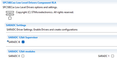

    Now click on "SARADC" in the Outline window
  7. Check the SARADC B 12B Supervisor box to enable it.

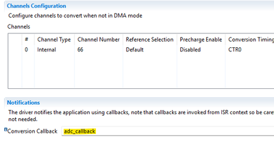

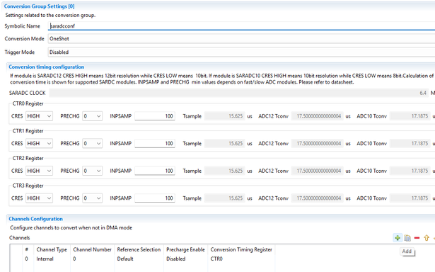

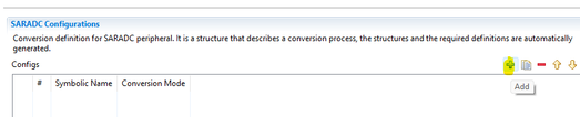

  8. Click on the green cross to add a new saradc configuraiton:SRomeo_12-1776238166555.png
  9. Double click it and the Application Configuration pane will show
  10.  Scroll down up to Channel configuration and add a new configuration clicking the green cross:SRomeo_13-1776238335124.png
  11. Double click it compile the Channel number edit box with the correct channel number (66)
  12. Now you have to add a name for a callback:
    (This will automatically be declared by the system with the name "<ConfigurationName>_<CallbackName>"once you click on generate, but needs to be defined somewhere in order to be called)
