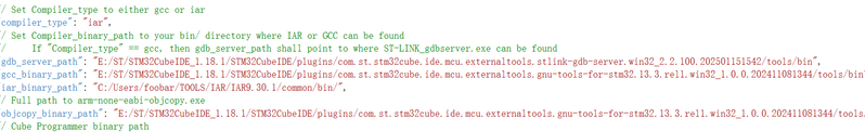

Hello @cxf,
As @Andrew Neil pointed out, this error seems to be because of a bad configuration of X Cube AI.
By default, the path to necessary tools are found automatically, but for some reason, it did not work for you.
Could you go to the X Cube AI repository folder:
C:\Users\lenovo\STM32Cube\Repository\Packs\STMicroelectronics\X-CUBE-AI\10.1.0\scripts\N6_scripts\
And manually set the paths in config.json.
Here is what mine looks like for reference:
    "gdb_server_path": "C:/ST/STM32CubeIDE_1.18.1/STM32CubeIDE/plugins/com.st.stm32cube.ide.mcu.externaltools.stlink-gdb-server.win32_2.2.100.202501151542/tools/bin",
    "gcc_binary_path": "C:/ST/STM32CubeIDE_1.18.1/STM32CubeIDE/plugins/com.st.stm32cube.ide.mcu.externaltools.gnu-tools-for-stm32.13.3.rel1.win32_1.0.0.202411081344/tools/bin",
    "objcopy_binary_path": "C:/ST/STM32CubeIDE_1.18.1/STM32CubeIDE/plugins/com.st.stm32cube.ide.mcu.externaltools.gnu-tools-for-stm32.13.3.rel1.win32_1.0.0.202411081344/tools/bin/arm-none-eabi-objcopy.exe",
    "cubeide_path": "C:/ST/STM32CubeIDE_1.17.0/STM32CubeIDE",
    "compiler_type": "gcc",
    "cubeProgrammerCLI_binary_path": "C:/Program Files/STMicroelectronics/STM32Cube/STM32CubeProgrammer/bin/STM32_Programmer_CLI.exe",
    "iar_binary_path": "C:/Users/foobar/TOOLS/IAR/IAR9.30.1/common/bin/"
(iar is not set as I don't use it)

Andrew Neil
It's telling you that it can't find arm-none-eabi-objcopy.exe:
ValueError: Path for entry objcopy_binary_path does not exist:
C:/Users/foobar/TOOLS/gcc-arm-none-eabi/12.2 rel1/bin/arm-none-eabi-objcopy.exe
Build error
So does that path actually exist on your PC?
Do you have access rights to it?
Would a failure to find arm-none-eabi-objcopy.exe be related to the .ioc file?
Sounds more like an installation/configuration problem with the tools?

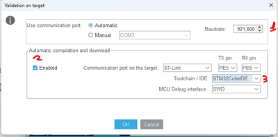

Hello @cxf,
Now that you corrected your objectcopy error, you can perform a validate on target in cubeMX.
To do so, make sure to put both pins on the right on your DK board (and reset the alimentation).
Then in cubeMX, click validate on target and use the config below:
This should work.

Thank you all for your help and time investment,I really appreciate it!!!
problem 1: objcopy path error
solution: by Julian E's way,i change my  config.json as
and it never output this problem
problem 2:
E200(ValidationError): TARGET: Unable to bind the ST.AI runtime with "network" c-model: []
 E801(HwIOError): Invalid firmware - COM35:115200
solution:it is the PLL and NPU CLK  reason, and i have set clk like this:
CPU=800MHZ,AXI =400MHZ,NPU=1GHZ,AXISRAM=900MHZ,HCLK=200MHZ
I hope these can help others,thanks!!
