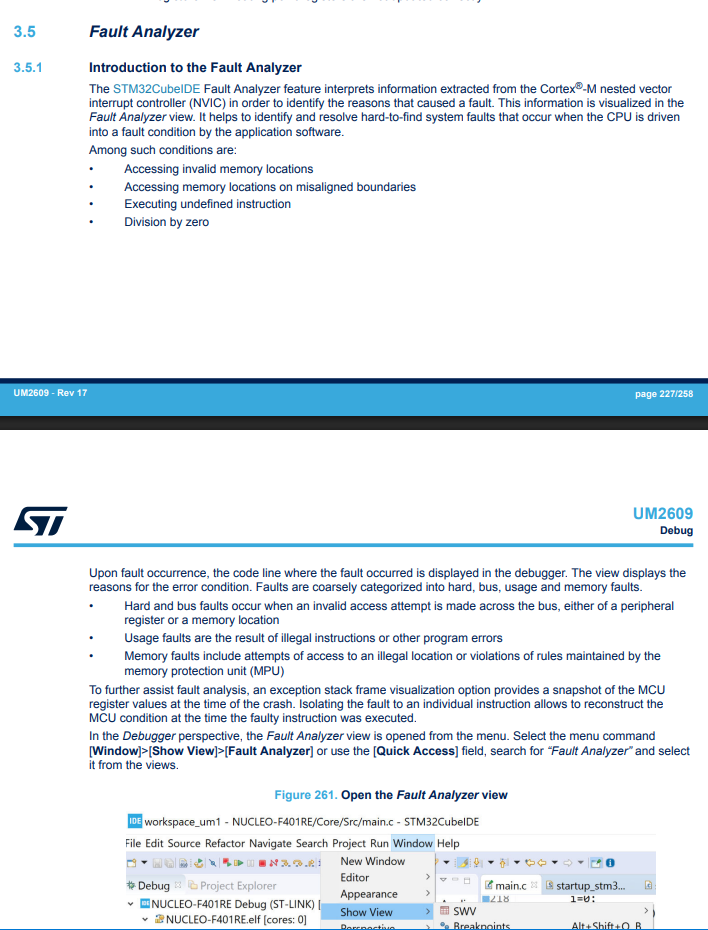

Andrew Neil
@Moussa1492 wrote:
2. Do tools like Ozone, CubeIDE, Cortex-Debug, or your own scripts already solve this well enough?
Yes, there is already a Fault Analyzer in CubeIDE:
https://www.st.com/resource/en/user_manual/um2609-stm32cubeide-user-guide-stmicroelectronics.pdf#page=227
See also How to debug a HardFault on an Arm® Cortex®-M STM32.
so you think it is a waste of time to invest in this project ?
