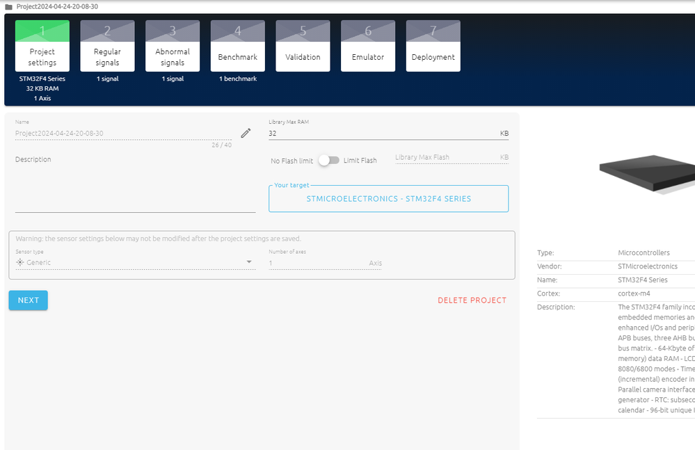

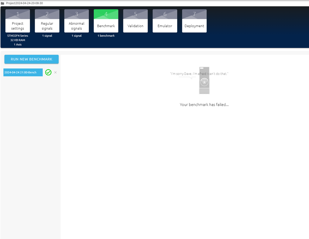

I used the simplest data for anomaly detection, but always failed to generate benchmarks. My setup screenshot with the data set is herelook forward to your replyQQ截图20240424210251.pngQQ截图20240424210243.png

The issue seems to come from the fact that you have special characters in your paths (Chinese characters if I am not mistaken).
We are looking for a solution, I will keep you updated.
Best regards,
Julian
Yes, some of my paths do contain Chinese characters, such as C:\Users\YOUR_USERNAME\ where YOUR_USERNAME is Chinese, but I installed NEAI in a path without Chinese characters. How can I solve this problem?
Looking forward to your reply!

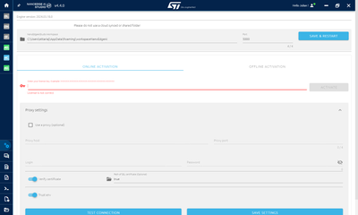

There are two paths used by Nanoedge:
  • The tool itself that should be in program file
  • The workspace with your project
Only the second one contains the special characters, and we can change its location directly in NanoEdge.
Go to setting and change the workspace location at the top:
For example, you can create a folder workspaceNanoEdgeAI directly in C: and select it.
You will need to click save and restart. Normally, you will not see your old projects (they are in the old workspace). You need to do a new project and see if it solved your issue.
Please let me know if it solved the issue or not.
Best Regards,
Julian
Maybe it is the reason for the special characters, for and in the ubuntu system installed NEAI, and it runs very well。 My problem is solved
