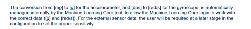

In developing some activity classification models using the LSM6DSOX, I have noticed that some information regarding the computation of features appears absent from the documentation. For some features (mean, min, max, maybe more), it would appear that the raw components (X, Y, and Z) as well as the norm are scaled by a factor of 1/1000; similarly, the norm squared variable seems to get scaled by 1/1,000,000. However, this does not seem to hold for other features like variance or energy.
This is based on analysis of results returned from the Unico API (as accessed from this repo: https://github.com/STMicroelectronics/STMems_Machine_Learning_Core/tree/master/tools/mlc_python_script). Below I have displayed two printouts comparing the Unico result and manual computation of features in Python.

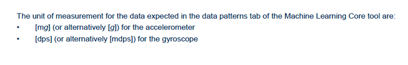

that's correct, there is a 1/1000 multiplier because the accelerometer data are converted from [mg] (the unit of measure in their standard log) into [g], according to the rule adopted by the MLC core (see the LSM6DSOX MLC app note:(
You can also find the following statements in the same application note:

Hi Eleon,
Thank you for your reply. That has cleared up my confusion.
Might I recommend that you please update the MLC app note to explicitly state that this conversion is occurring? I understand it is implied by the section you quoted; however, I think it would likely save others the time and confusion I have encountered.
Moreover, it is also critical to mention that the gyroscope is also scaled to entirely different units from the units of the standard log. Namely, degrees per second is converted to radians per second (multiply by pi / 180). If you could please update/edit your answer to include this fact as well, I will happily select it as the best. I would just prefer the complete answer to be in a single post for any future readers.
