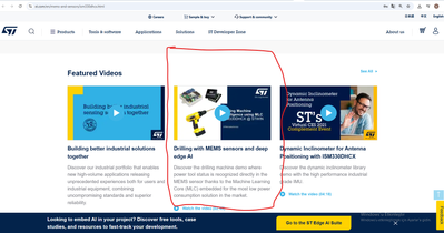

I’ve been working on a project inspired by STMicroelectronics project, where the goal is to identify different operation modes of a power drill — such as drilling, screwing, and idle — using motion sensor data.
I’m using one of ST’s development kits (e.g., STEVAL-STWINKT1B) and built my classification model using NanoEdge AI Studio.

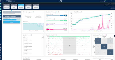

Hello @burak_Guzeller,
Concerning the behavior you observe in NanoEdge, it is because you provide files without enough data to do all the tests in the matrix.
As you can see, it will test multiple combination of buffer size and downsampling.
With 189 lines, it cannot test all the tests in grey.

burak_Guzeller
I have been following your Drill State Detection project (for in referans : https://www.st.com/en/mems-and-sensors/ism330dhcx.html) using the STEVAL-STWINKT1B kit and the ISM330DHCX sensor. I have followed all suggested steps and attempted to compile the project, but the process takes a long time and sometimes drilling and screwing modes are confused.
Could you kindly provide the source code and data logger files? These materials are urgent and critical for our project. For reference, here is the ISM330DHCX sensor page.
Thank you,
Could you please respond to my post? This project is very critical for us and we still haven't found a solution. We've tried all the filters, but we haven't received any definitive results. When I did it as in the idea, the correct results weren't obtained. I added a lot of data signals, but it didn't work. Could we get the source code or the .csv file? That would be great.
