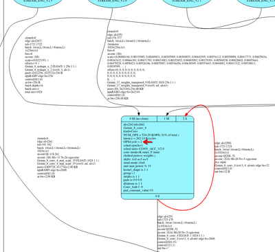

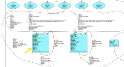

But I have a question about the MAC/cycles of power-of-2 Gemm operations doing 1024*256 MAC.
It seems to not use the full CONVACC MAC/cycles, according to the reference manual, one CONVACC is able to do at most 36 16*8 MACs:
But the 1024*256 Gemm operation seems to only use 2 MAC/cycles according to the tmp.dot graph output of atonn and the real timing when measuring on STM32N657 hardware :
Is there a way to improve the MAC/cycle ratio to speed-up inference ?

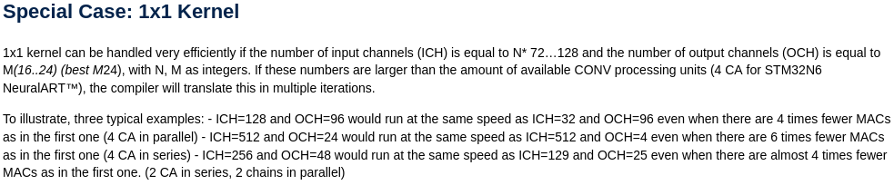

I see this paragraph in ST Edge AI documentation which may be related :
What "run at the speed" means ? The inference speed would be the same ?
As I have ICH=256 and OCH=1024 in my case, am I limited by the OCH = N*16 (with N = 64) ?
I'm attaching the quantized model generated by stedgeai in st_ai_output folder and the tmp.dot converted to svg format.
Hello @AMurz.1,
Here is the answer from our experts:
The 2Mac/cycle there, is the maximum theoretical value that we can obtain here, given all the conditions around including memory access etc.
In the screenshot of the SVG graph, you can see that there is a property of the conv node saying that the "choked ports = (weights)". This is due to the fact that we don't have any data reuse with GEMM node, since each value is read and used only once. That's why we don't get better measures in terms of Mac/cycle like the maximum ones stated here by the user:
furthermore, the 16x8 simd mode is enabled (chosen since we have an FSUB !=0) and thus we can't enable the Deep1x1 mode
Have a good day,
